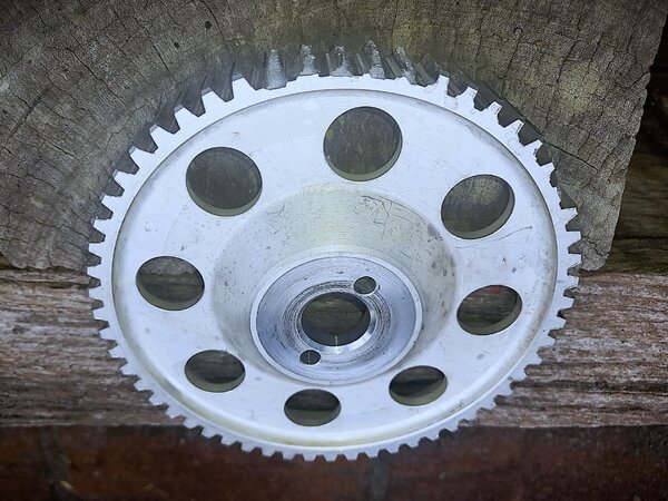

Lucky Phil Posted July 31, 2024 Posted July 31, 2024 (edited) Not only the aluminium oil pump gears that fail on the high cam engines. Total rubbish. Edited July 31, 2024 by Lucky Phil 3 1
Lucky Phil Posted July 31, 2024 Author Posted July 31, 2024 7 minutes ago, DucatiGuzziIndian said: how many miles on that Phil? Don't know the image was sent to me from Joe Caruso because we discuss engineering things/designs etc. I have several sets in my workshop with bad drive face wear on the teeth which I don't really trust for the reason shown in the image. Every material has it's place and aluminium for cam gears isn't one of them for mine unless it's some sort of sprint engine and longevity isn't an issue. Phil 2
pete roper Posted July 31, 2024 Posted July 31, 2024 I have a whole ‘Chamber of Horrors’ file of pics of Alloy timing gears and alloy/steel composite sets. None of them are, or were, ever worth a pinch of shit! Criticising them has led to threats of violence being made against me by mentally unstable and drug-fu*ked individuals so I tend not to say anything about them nowadays beyond just advising strongly against their use. I’ve spoken with Joe about these gear sets though and we’r in complete agreement. You wouldn’t use them in a lawnmower! Much less a motorbike! 3

Weegie Posted July 31, 2024 Posted July 31, 2024 I replaced the OEM alloy gears in my HiCam engine with steel versions from Joe The OEM crank driving gear is steel, but the oil pump and cam were allo I just thought it was prudent, the amount of effort to turn an engine and compress the valve springs said to me that it might not be prudent to have alloy as a suitable material
GuzziMoto Posted July 31, 2024 Posted July 31, 2024 Gear cam drive is good, but aluminum gears for that are not a good idea for a street motor, as said. It just isn't what aluminum is good for. Strange that Guzzi went with some of the gears in aluminum for the high cam motor. But they do screw up occasionally. That said, while I would convert a chain drive cam set up to gears, I would only do so if the gears in question were steel or another suitable material. 1
