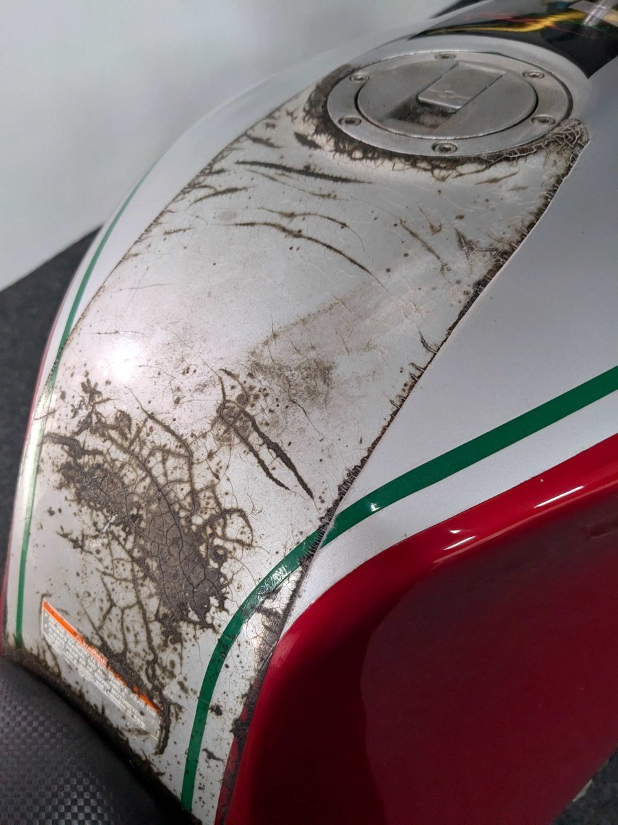

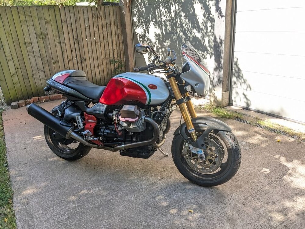

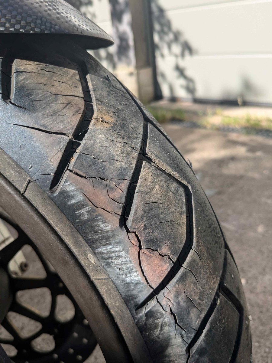

wavey_davey1 Posted August 21, 2024 Posted August 21, 2024 Ok, so as per my recent "introduce yourself" post, I have bought a Coppa Italia imported from Japan by a dealer, described as a "barn find". In this case I actually think it might have been in a barn! The date code on the tyres is 2007 and there's numerous signs around the bike of having been stored either in slightly damp conditions and/or UV damage though fundamentally in good condition? I suspect it might be a deceased estate purchase as there's a few expensive extras that came with it, but also signs of poor storage, we'll never know? I'm no stranger to restorations (which is not how I see this project) having resurrected a T3 Cali, numerous 60s/70s Bonnevilles and Commandos etc, but never really had that much involvement with a spine frame over and above tank-off checklist type stuff. I see this one as requiring a bit more than that somehow! First hurdle was getting the badly uv hardened paint film off without destroying the paint and decals underneath. So far it's working, albeit very slow process (combination of gentle heat gun and specialised solvent) but the tailpiece decals aren't clearcoated so will have to repair small areas or source new ones/get copies made, we'll see. I wanted to clean it up a bit before any stripdown or startup, as much to give me some motivation as anything else. It's really filthy, even under the tank etc. Oddly though oils look clean as does brake fluid, and there's a small amount of what looks like reasonably fresh fuel in the tank, which I'll change out before powering up the pump etc. I've sourced new oil, oil filter, fuel filter and just had 10 Picker relays arrive from Digikey in the states (2 days shipment time!) as it currently has the dreaded Tycos. Will post a few updates as and when, (and steer specific questions into the technical forum) though this project is competing with my brother's BSA 250 charging issue and a few other bits and pieces, plus the demands of a 10 year old daughter, so it's not going to be a 2 weeks and ride off into the sunset thing. 7
wavey_davey1 Posted August 21, 2024 Author Posted August 21, 2024 but looking a bit better with a bit of a clean (still some paint film to go at but my finger nails are literally wearing down (an old credit card proved useless) 8
Admin Jaap Posted August 22, 2024 Posted August 22, 2024 It's settled then... we ride old bikes. The first V11 barnfind is documented. 5 5

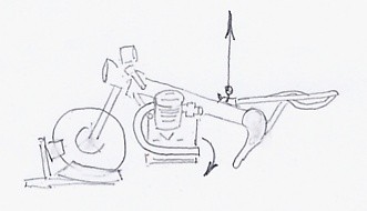

docc Posted August 24, 2024 Posted August 24, 2024 Having removed the throttle body "assembly" from mySport, it is best performed with the frame "crabbed." Otherwise, one has to get one of the throttle bodies off the rack in situ. It can be done, but likely to double your vocabulary . . . 1
activpop Posted August 24, 2024 Posted August 24, 2024 Pardon my ignorance@docc, but what do you mean by crabbed?
docc Posted August 24, 2024 Posted August 24, 2024 4 minutes ago, activpop said: Pardon my ignorance@docc, but what do you mean by crabbed? "Crabbing" the SpineFrame may well be an early P.Roper-ism . . . Chocking the front of the bike whilst loosening the front engine mounts and releasing the rear mounts to hoist the rear of the SpinFrame up off the chassis: 1 1

wavey_davey1 Posted August 25, 2024 Author Posted August 25, 2024 13 hours ago, DucatiGuzziIndian said: Wavey Dave, how many k's on the bike? Those tires look fine! your worrying about nothing... ;-) JK of course. Reminds me of a saying: "I love hard work, I can watch it for hours!" Good luck with this,.... fingers crossed that it's not too bad. About 37000 Kms or 23000 ish miles so not huge but was used back in the day? There's what I'd call localised corrosion on areas like some of the frame joints where water could have pooled but mostly it's in good condition with the rubber component deterioration pointing at UV damage more than anything. However paint is unfaded (maybe a bit on the pork chops) but none on the silencers for example which I know can fade? This bike's history seems full of contradictions!
