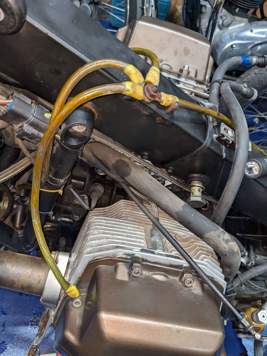

wavey_davey1 Posted September 23, 2024 Author Posted September 23, 2024 Weird/Ugly earthing arrangement! 1 1
gstallons Posted September 23, 2024 Posted September 23, 2024 It looks like they were trying to correct something . And it wasn't working.

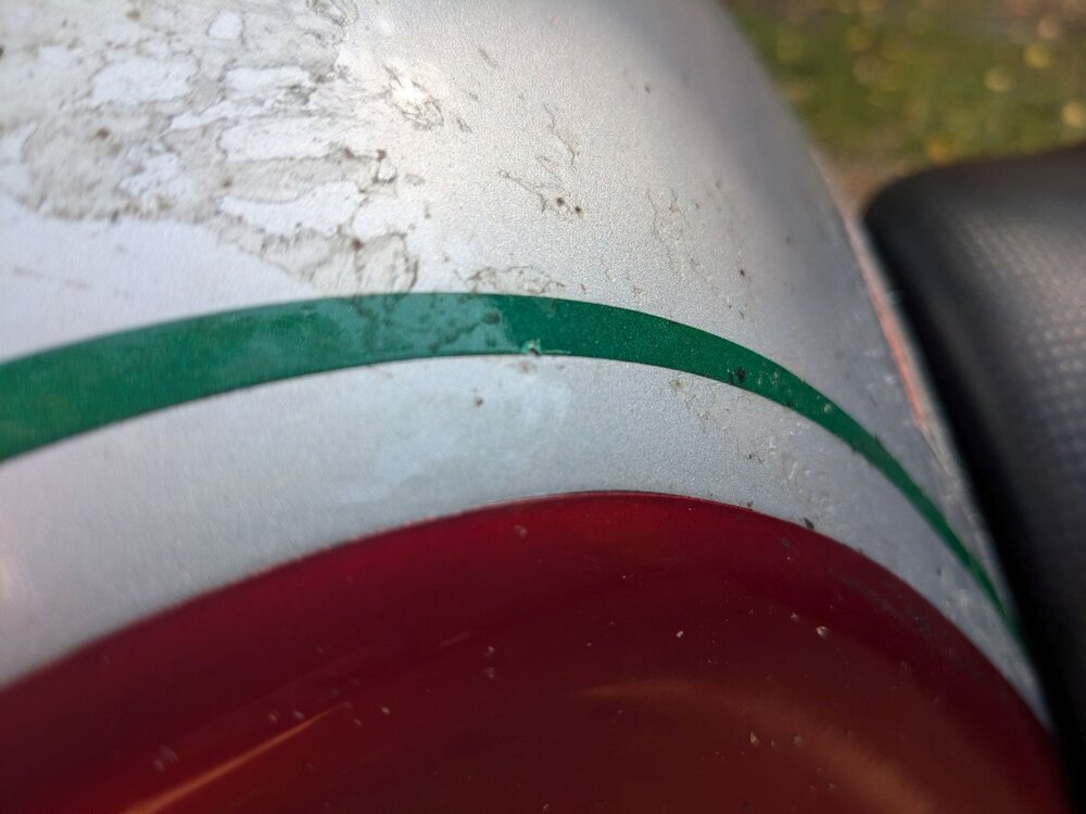

wavey_davey1 Posted September 29, 2024 Author Posted September 29, 2024 Never seen one of those decal removal "wheels", interesting but a bit late for my purposes. Also given the brittle nature of the film, all bets are off on it working I suspect?! Yes I've been using a heat gun along with the solvent. The film was way too old and UV hardened (what a surprise) to peel off, it would just break off in tiny flakes. Slightly easier on the tail area for some reason. I also went too hot in a couple of spots and managed to damage the green stripe in the paintwork with my nail. Not a huge mark but annoying given I was being really careful. I'd assumed it was reasonably well protected under a clear coat, oh well - see pic. Yes I'm ahead of you (for once) gstallons, I've had the drained tank sitting with fuel cap open and pump plate removed for over a week now to "dry out". I'm trying to do as many jobs as possible up to first fire-up before replacing tank (drying out) and sump (waiting for Roper Plate). Probably a good idea to actually remove the cap as you say, but with the plate off it's getting pretty well aired. Thanks for all the input guys. 1

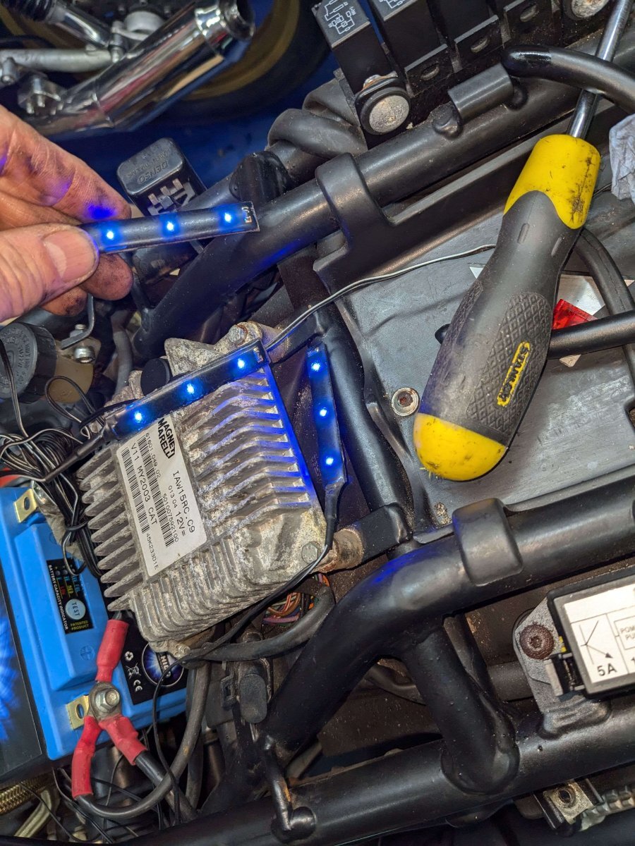

wavey_davey1 Posted September 29, 2024 Author Posted September 29, 2024 Also connected battery for first time after cleaning up relay mounts and installing the new Picker relays (and removing the pump fuse). Those weird led lights turned out to be side marker lights rather than indicators. Never seen anything like that before and the masses of wires used to connect them up all removed now. The aftermarket "on/off" switch mounted on the instrument binnacle is a headlamp on/off, presumably to save battery drain as it's been fitted with a PIAA 80w halogen unit. All the other electrics seem to work ok, I'll only reconnect pump when tank back on. I might just refit sump without roper plate, do oil fill and do a proper (albeit cold) compression check as starter motor seems fine?
