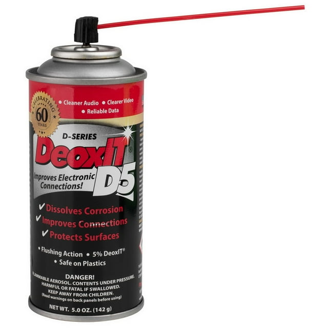

Pressureangle Posted October 5 Share Posted October 5 (edited) Yeah, the ol' electrical ghost in the machine. Mine's a '97, so the relays aren't in the same place, but I had the same troubles. New relays helped, but at the end of the day It took getting mad enough to truly service the entire relay/fuse panel properly. I disassembled it as far as possible- I don't mean that I removed every terminal from the block- but had a good look at everything and remade every connection I could find, to the battery and to the frame. What truly resolved the problem was giving every terminal a bath in CAIG DeOxit D5. I'll never be without it, amazing stuff. FWIW, I've been able to source the above referenced OMRON relays in any quantity from my local pick-n-pull junkyard; they're in pretty much every Jeep product. I pull the ones lightly used, whatever they may be- not engine fan, headlamps, fuel pump but rather fog lamps, horn, etc. Edited October 5 by Pressureangle add info 2 Link to comment Share on other sites More sharing options...

docc Posted October 5 Share Posted October 5 Prying up the fuse block will let you inspect these hidden spade connectors to Fuse #1 and #2. Make certain they are clean and tight. The Caig Deoxit® @Pressureangle referenced is highly desirable for every connection you open and reseat. 1 Link to comment Share on other sites More sharing options...
Sporticus Posted October 5 Author Share Posted October 5 Just ordered a can of Deoxit. Thank you. I also swapped the fuel pump relay with the starter relay (and vice versa). The fuel pump primed and the relay only clicked once (as opposed to the staccato drum roll it had been doing). Maybe just a bad relay? I’ll try again when the bike is stone cold) 1 Link to comment Share on other sites More sharing options...
