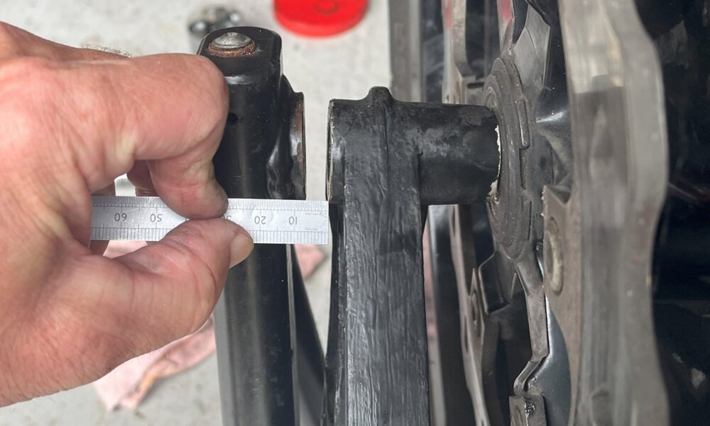

PeterT Posted Sunday at 12:15 PM Share Posted Sunday at 12:15 PM The next time a member removes the rear wheel of their V11, I would be very pleased if they could measure and post the axial widths/dimensions of the 4 main components that go in-between the arms of the swing-arm. In order of assembly, from right to left, the bevel transmission, the small spacer collar, the wheel and the cast brake calliper bracket. Is there anything else? The reason I am asking this is that I have a 6.5mm (just over 1/4") gap between the inside of the swing-arm and the brake calliper bracket once the wheel and transmission are pushed to the right. For the last 10 years the bike has run with a bespoke alloy swing-arm and when refitting the wheel, the brake calliper bracket has been a perfect push fit into the gap between the swing-arm and the left hand wheel bearing. I have now tried to fit the original steel swing-arm and found this gap that I believe is too big to simply squeeze the swing-arms by tightening up the axle bolt. Someone please tell me if I'm wrong on this and if such a gap is normal. I have measured the original steel swing-arm and the dimensions seem to be in line with the dimensional specification given in the technical manual, namely 301mm between the inside faces of the swing-arms. My suspicion is that the alloy swing-arm (that I no longer have) had a slightly smaller dimension and that the brake calliper bracket was reduced in width; hence my request for someone to measure this and, in case this is no different, the other components as well, though I really cannot see how these can have been changed from the original design specification. If the brake calliper bracket has been modified, then at least I will know that, if I bought a new replacement, that this would solve my problem. The dimensions I have measured are:- Bevel transmission gear - 90.06mm (3.54") Spacer collar - 12.4mm (0.488") Wheel (across bearings)- 141.8mm (5.58") Brake calliper bracket - 50.45mm (1.99") Total 294.7mm Dimension between swing-arms- 301mm Gap - 6.3mm Link to comment Share on other sites More sharing options...
Pressureangle Posted Sunday at 01:00 PM Share Posted Sunday at 01:00 PM Not clear in the photo, but looks like you're missing, or have a shortened, spacer between the wheel and brake caliper bracket. Link to comment Share on other sites More sharing options...
docc Posted Sunday at 02:51 PM Share Posted Sunday at 02:51 PM Your brake caliper bracket certainly looks modified, @PeterT and the gap is not normal. My caliper bracket measures 58mm from the swingarm to the wheel and 31mm from the inside of the rib (that is mostly removed from yours) to the wheel side: Link to comment Share on other sites More sharing options...
audiomick Posted Sunday at 03:52 PM Share Posted Sunday at 03:52 PM 3 hours ago, PeterT said: ...components that go in-between the arms of the swing-arm....is there anything else? I don't think so, but would have to look at the bike to be really sure. @docc 's photo seems to answer your questions clearly, though. Here is a link to a parts list. The relevant exploded drawings for all the parts you listed are unfortunately not all on one page, but if you leaf through it, you can piece together what should be in there. https://guzzitek.org/parts_list/gb/1100/V11LM_2002_062011_PL(GB).pdf If you want other documantation, here is the "front page" of the site: https://guzzitek.org/gb/accueil_gb.htm 1 Link to comment Share on other sites More sharing options...
PeterT Posted Sunday at 04:21 PM Author Share Posted Sunday at 04:21 PM Thanks for this. You seem to have confirmed my suspicion and solved the mystery of the missing millimetres! 1 Link to comment Share on other sites More sharing options...

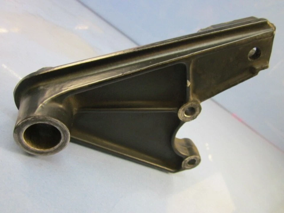

docc Posted Sunday at 06:47 PM Share Posted Sunday at 06:47 PM eBay/The Netherlands: https://www.ebay.com/itm/132409184322?_skw=01635840&itmmeta=01JANM0DQRP1GDP3G61PJXHHKJ&hash=item1ed433d042:g:KwkAAOSwa5ZkWdpd&itmprp=enc%3AAQAJAAAA4HoV3kP08IDx%2BKZ9MfhVJKnF3fEyiANuiVHgO0tD9H2AZ9gy%2BJA36acy8CIMa9W2bkhQn85DwUnLBo3KOJmbdg6PA%2FfWsZW5niOgb6PjJH9TqZOy3aP2jNdUpRc%2B3zumGn1J9yWVrQ1uAfP22V9jqg%2BTq4EoLqAO9y0vWUuDC5bKHQjRtGLCZlaTyYJLcGIhwhAWOf%2BeA2mlfetk8MAOBJ2A4%2Bs5cDrTxsYqACxRWQocf%2BXoETcKWoOmsTk36VFDusfFLwXMdfVD7awfvlDTnZZSUDGDmmcZE85VIvmczrVf|tkp%3ABFBM9tuBtNVk Image: https://i.ebayimg.com/images/g/KwkAAOSwa5ZkWdpd/s-l960.webp 1 Link to comment Share on other sites More sharing options...
Lucky Phil Posted Sunday at 09:13 PM Share Posted Sunday at 09:13 PM (edited) 9 hours ago, PeterT said: The next time a member removes the rear wheel of their V11, I would be very pleased if they could measure and post the axial widths/dimensions of the 4 main components that go in-between the arms of the swing-arm. In order of assembly, from right to left, the bevel transmission, the small spacer collar, the wheel and the cast brake calliper bracket. Is there anything else? The reason I am asking this is that I have a 6.5mm (just over 1/4") gap between the inside of the swing-arm and the brake calliper bracket once the wheel and transmission are pushed to the right. For the last 10 years the bike has run with a bespoke alloy swing-arm and when refitting the wheel, the brake calliper bracket has been a perfect push fit into the gap between the swing-arm and the left hand wheel bearing. I have now tried to fit the original steel swing-arm and found this gap that I believe is too big to simply squeeze the swing-arms by tightening up the axle bolt. Someone please tell me if I'm wrong on this and if such a gap is normal. I have measured the original steel swing-arm and the dimensions seem to be in line with the dimensional specification given in the technical manual, namely 301mm between the inside faces of the swing-arms. My suspicion is that the alloy swing-arm (that I no longer have) had a slightly smaller dimension and that the brake calliper bracket was reduced in width; hence my request for someone to measure this and, in case this is no different, the other components as well, though I really cannot see how these can have been changed from the original design specification. If the brake calliper bracket has been modified, then at least I will know that, if I bought a new replacement, that this would solve my problem. The dimensions I have measured are:- Bevel transmission gear - 90.06mm (3.54") Spacer collar - 12.4mm (0.488") Wheel (across bearings)- 141.8mm (5.58") Brake calliper bracket - 50.45mm (1.99") Total 294.7mm Dimension between swing-arms- 301mm Gap - 6.3mm You are correct, the calliper bracket has been reduced in width on the OB side. Here's the std width. Phil Edited Sunday at 09:22 PM by Lucky Phil 1 1 Link to comment Share on other sites More sharing options...
PeterT Posted Sunday at 09:23 PM Author Share Posted Sunday at 09:23 PM That's what I like about this membership forum; there are always people willing to provide good advice. Many thanks for all your helpful replies. 2 Link to comment Share on other sites More sharing options...
gstallons Posted Sunday at 11:21 PM Share Posted Sunday at 11:21 PM I cannot understand why the mod and it's purpose ? Link to comment Share on other sites More sharing options...
Pressureangle Posted Sunday at 11:56 PM Share Posted Sunday at 11:56 PM Teo Lamers has a 'Sport bracket, and a few V11 brackets; I think they're the same but not certain. https://en.tlm.nl/moto-guzzi-triumph/us-37635805-used-remankerplaat-sport-1100 Link to comment Share on other sites More sharing options...
docc Posted yesterday at 12:20 AM Share Posted yesterday at 12:20 AM 1 hour ago, gstallons said: I cannot understand why the mod and it's purpose ? 12 hours ago, PeterT said: . . . For the last 10 years the bike has run with a bespoke alloy swing-arm . . . " Ghezzi-Brian V11Trofeo " ? ? 2 Link to comment Share on other sites More sharing options...
gstallons Posted yesterday at 08:50 AM Share Posted yesterday at 08:50 AM Was it ground down to make it fit this application ? Link to comment Share on other sites More sharing options...
audiomick Posted 13 hours ago Share Posted 13 hours ago No doubt it was. I have the impression that some of the ribs have been "reduced" too, though it is hard to tell from the photos here in the thread. That would be to save a couple of grammes, I guess... Link to comment Share on other sites More sharing options...
