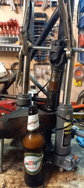

Celebratory beer... Had to look a the manual's drawing to appreciate how releasing fluid would find its way to the splines. Removed the grease nipple and put loads of WD40 in that way. Reassembled my contraption, heated the heck out of it, and it finally let go.

That's quite the assemblage of stuff in the shop to create pull. Where there's a will there's a way. I like it.  In hindsight,  I wonder if putting the drive shaft assembly on a press would have worked. When the unit is on the bike I don't think it is bottomed out.  It can move either way and the goal was just to break it free. It is just a thought. Unfortunately,  I just thought about it today after following this post. We were all zeroed in on pulling, when pushing might have been been an easier option.
Here's the thing. The splines were clean but dry. Because there's a small hole (appears like the plug simply hasn't been welded-up properly - not an engineered hole) grease seemed to be stuck at one end and would escape rather than find its way along tge splines. Path of least resistance I suppose.

Looks like it was not so much the spline as the shaft itself that was causing grief. Is that the case?
