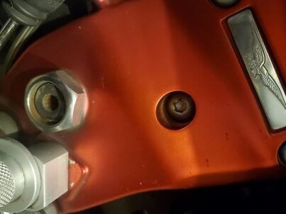

docc Posted November 5, 2024 Posted November 5, 2024 15 hours ago, Lucky Phil said: I'm trying to remember if the plates are cast or forged and unless something has changed over the last 10 years you'll not have much luck anodising them if they are cast. Your local anodiser won't usually touch any cast part because the surface finish never turns out well and will be powdery and blotchy. The Italian manufacturers such as Brembo have some sort of special anodising process for cast parts such as master cylinders and callipers etc that your average anodiser here and in the states does not. It's the reason cast ally car wheels aren't anodised but usually power coated. Billet and forged parts are different though. These days you can get powder coating that closely replicates an anodised finish anyway. I have always thought the frame side plates were cast. Not sure if this image helps make that discernible . . .
audiomick Posted November 5, 2024 Posted November 5, 2024 9 hours ago, docc said: I have always thought the frame side plates were cast. It never occurred to me that they might be anything else. They certainly look like cast items to me. 1
