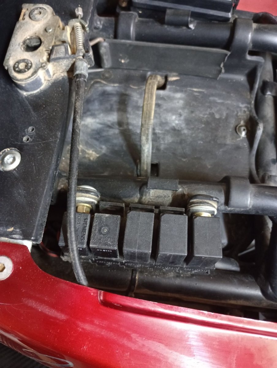

footgoose Posted November 26, 2024 Posted November 26, 2024 14 minutes ago, WDGUZZI said: and no fuel pump prime. neutral light may be a bulb or other. relay #5 far to the rear runs the pump. swap it out with new or another one, maybe #3 (docc?) and see if the pump works. clean contacts of all of them. what brand of relays are in it? lesser ones do go bad. 1
WDGUZZI Posted November 26, 2024 Author Posted November 26, 2024 Thank you footgoose! I bought a bunch of 5 pin relays from a source noted on Wildguzzi for my 1998 California. I understand that I can replace both the 5 pin and 4 pin relays with 5 pins on the 98, so maybe I can on the Lemans as well? I'll give it a try but first switch with the #3 relay. All the relays appear to be in excellent condition with no corrosion (unlike my 98). I don't know the relay brand but will check when I get home from work later today. 1

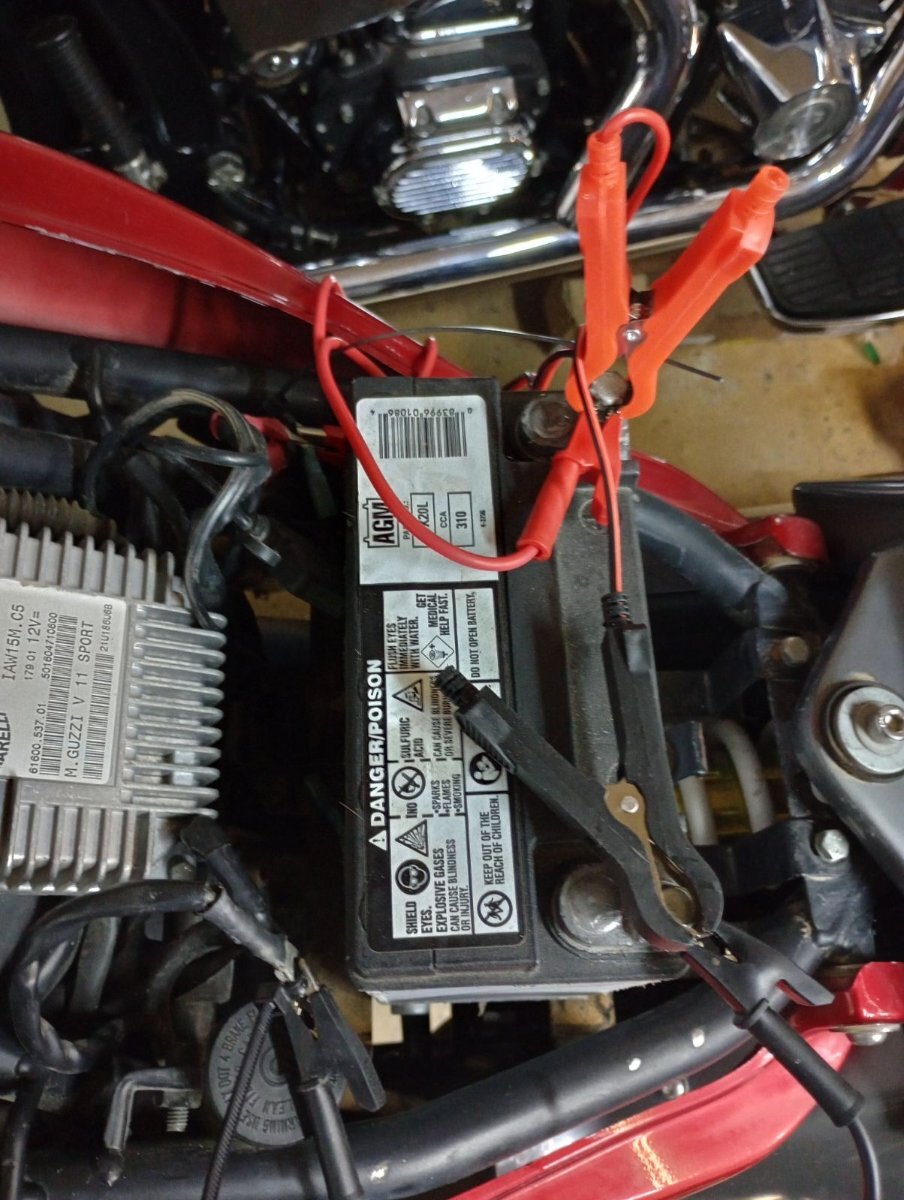

docc Posted November 26, 2024 Posted November 26, 2024 Welcome, @WDGUZZI! As you can see already, you are in the right place to sort a V11 LeMans! Could you post images of the electrical menagerie under the seat? Sometimes, a look at that will reveal modifications and monkey business . . . 4
audiomick Posted November 27, 2024 Posted November 27, 2024 (edited) 4 hours ago, WDGUZZI said: ... a 'startus interruptus' mod that I assume is some sort of kill switch? .. No. A number of Guzzi models, including the V11 series, were (are) prone to becoming reluctant to start with time. Some of them (not the V11, I believe, later models) had a function in the engine management that prevented starting if the system thought the voltage was too low. Others (including the V11 and my Breva 750) just don't get enough volts to the starter solenoid to pull it in properly and activate the starter motor. The solution for the V11 and my Breva is to provide power, switched by a relay, directly from the battery to the starter solenoid (with an in-line fuse). Easy on the Breva, but on the V11 it requires an additional relay. Never mind that for now, though. Going by your description, that is not your problem, or at least not your first problem. That is a topic that you can get into later, I reckon. Edited November 27, 2024 by audiomick 1

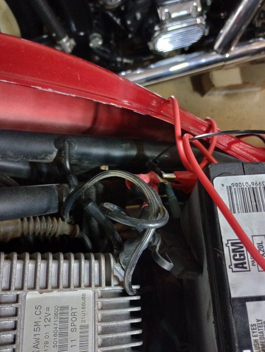

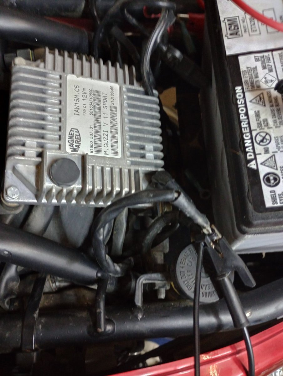

WDGUZZI Posted November 27, 2024 Author Posted November 27, 2024 Yes, happy to post more pictures! I think the previous owner was a caring one. There is battery tender wiring and not shown is a very complete tool kit I removed to check things out. The janky-est thing I can see of the wiring is my makeshift jumping of the battery cables while I wait for the correct size battery. 1
audiomick Posted November 27, 2024 Posted November 27, 2024 So you've apparently jury-rigged a battery to try and get it started. Are you absolutely sure you connected all the cables that need to be connected to the battery? "Stupid" question, I know. Just for the sake of completeness. 1
docc Posted November 27, 2024 Posted November 27, 2024 These can be vastly improved upon . . . Might as well get yourself a set (5) of High Current relays: https://www.digikey.com/en/products/detail/picker-components/PC782-1C-12S-R-X/12352866 2 1

WDGUZZI Posted November 27, 2024 Author Posted November 27, 2024 I agree that maybe the zip tied battery cables should be bolted and so I'll do that. I'll look for those relays as well. Thanks for the tips! 2
