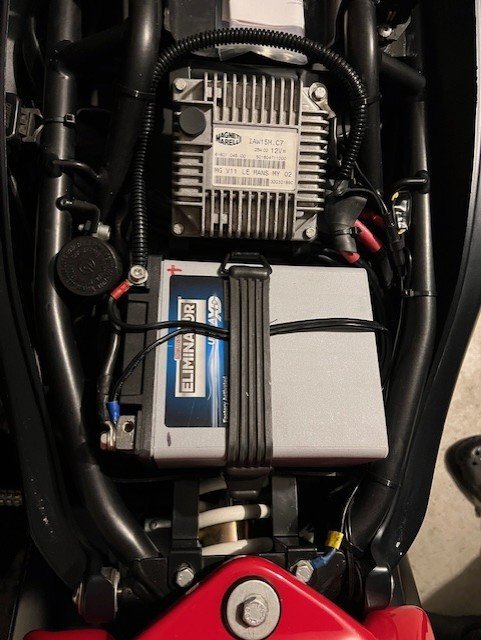

PhillipLarsen Posted January 4 Posted January 4 Hello LangleyMalc Not too long ago I also had to replace my second Odyssey in my 2004 Ballabio here in Metro Vancouver (part of my 20-year-old bike update), as it became unable to start the V11. I had good experiences with the Odyssey's (12 and 8+ years) but getting one here was weeks away, and I needed much sooner. I decided to try find a Matgas locally to replace it, even if temporarily. The only one I could find locally of the same size and storage capacity at the time was a Moto Master Eliminator XD Power Sport ETX15L that was in stock (Canadian Tire) and of very recent manufacture date. Price was quite a bit less that Odyssey (around 150 Cdn). The terminal configurations were wrong however I made up one heavy cable for the positive side to run to the group of cables that attach to positive. It worked out very nicely resulting in an installation that is much easier to install and remove the battery. The next time I will try plan ahead for an Odyssey. I may try find a terminal layout the same as this battery due to the convenience of the installation. On another note, you should bring your Ballabio to one of the Moto Social monthly meets when they start again in May. VANCOUVER - The Moto Social There were several other v11's there during some of the 5 events last summer, one being a 2004 Lemans in red looking really nice, and my 04 Ballabio.
