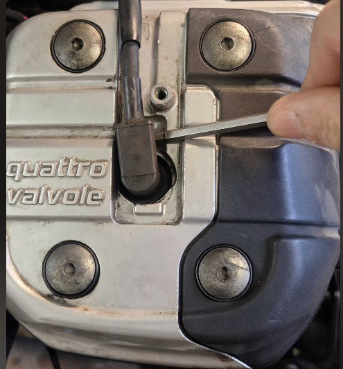

Kuni0 Posted Tuesday at 05:31 PM Author Posted Tuesday at 05:31 PM (edited) Well, I'm the ape that been servicing my Stelvio, and have for the past 60k miles. Whenever I'm removing the plug caps, I take a long allen head socket and guide it under the plug cap and pop it up, as seen in the picture below. (feel free to call me a moron if I've actually been screwing it up) Edited Tuesday at 05:36 PM by Kuni0 1

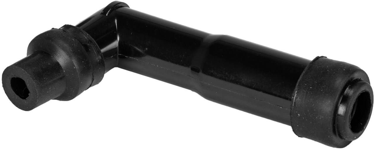

Kuni0 Posted Tuesday at 05:33 PM Author Posted Tuesday at 05:33 PM Also, running plug caps. These are the standard ones from the factory to my knowledge 1

pete roper Posted Tuesday at 08:01 PM Posted Tuesday at 08:01 PM (edited) Well, that is likely your problem. The caps are very soft and tear easily. Levering them off from the top as shown almost invariably damages them. It may not be obvious at first glance but if you remove the lead covers and spin the bike over in a dark garage you will likely hear, and probably see, the spark *Snapping* to earth between the right angle of the cap and the rocker cover. The factory supplied, at enormous cost, a sort of grabby tool that you could slide down the cap to grip it and pull it up. I’ve never seen one! Ain’t nobody gunna pay for that nonsense! The way to remove the caps without damage is to get a long, thin, flat bladed screwdriver and poke it into the cooling tunnel in the head just above the exhaust manifold. Prod around with it and you’ll feel the soft rubber of the cap. You can then hook the end of the blade under the bottom of the cap and lever the cap up, off the electrode. Once the cap’s clip is clear of the electrode tip then and only then do you grab the cap at the top and wriggle it out with a gentle twisting motion. When reinstalling give a light smear of rubber grease around the sealing ‘rings’ on the cap to make it easier to slip out next time. Now the common replacement for the rather delicate original caps used to be NGK SB05-E or F caps, the suffix letter denoting the fitment for the tip shape of the plug centre electrode. Thing is NGK have ceased production of plug caps due to lack of demand, (Everything having moved to plug top coils.) but nature abhors a vacuum and there is another mob whose name I can’t remember off the top of my head who have stepped into the breach. I think though I put a link to their site up on Griso Ghetto, (Which is probably your best source for 8V info and yes, we like ALL CARC bikes so you won’t be ostracised!). The NGK caps don’t have the right angle tops and you have to bend the HT lead over to fit it under the lead cover which looks a bit ugly but it works. If you’re lucky you may find a set of NOS NGK caps on fleabay or the like. Next up in your steep learning curve will be understanding how the W5AM ECU controls the engine and why you should never move the ‘Sacred’ throttle stop screw while tuning it! Edited Tuesday at 08:03 PM by pete roper 2 1
Pressureangle Posted Tuesday at 08:53 PM Posted Tuesday at 08:53 PM (edited) https://firepowerparts.com/spark-plug-cap-sb05e-replaces-ngk-8374/ Here's another one that may be a better fit- of course, I have no 8v nor this plug boot to hand, but if it was me I'd waste the money on a set to try. https://firepowerparts.com/spark-plug-cap-xb05f-replaces-ngk-8062/ Edited Tuesday at 08:55 PM by Pressureangle 2
pete roper Posted Tuesday at 09:55 PM Posted Tuesday at 09:55 PM Worth a try but I don’t think it will be long enough. 2
pete roper Posted Tuesday at 10:53 PM Posted Tuesday at 10:53 PM 11 hours ago, gstallons said: Pete , are these solid core wires and the plug caps screw in ? Also , if these are solid core wires , they will have resistors in the caps ? My red frame had a hick-up / miss and one of the caps were "open" . They are copper core wires and yes, resistor caps. The resistor can be damaged by careless prying but in this case I’m pretty certain the problem is down to the rubber of the cap being torn. The fact it was raining when the problem arose is one indicator. Thing is when damaged the caps quite often don’t start arcing immediately. It seems to usually take about five to thirty Km for the problem to appear. Just far enough for it to be bloody inconvenient! Once the arcing happens though it’ll form a carbon track through the crack in the rubber and it’s all over red rover! Taking the plugs out and putting them in the caps and testing them against the heads is fine. You’ll still get a spark at the plug because the crack in the cap is away from the head and the spark isn’t being stressed. Electricity takes the path of least resistance and outside of the engine jumping the plug gap is easy. Once the plug is in the head the conditions, heat, compression etc. are far more hostile and so the spark looks for an easier route to earth. A nice damp crack in the boot of the plug cap is perfect! Wham-Bam-Thankyou-Mam and it’s all over bar the shouting. It’s really important NOT to ride in this condition as the uncombusted fuel from the dead cylinder gets pumped through into the exhaust where it can combust in the catalytic converter. That as you can guess is when the fun really starts! 4

pete roper Posted Wednesday at 12:14 AM Posted Wednesday at 12:14 AM (edited) Caps. http://kandstech.com/productreleases/sprc.pdf Note. This will be useful for V11 owners too as you will probably need new caps after you bin it. From memory the NGK’s were SB05’s caps. Edited Wednesday at 12:16 AM by pete roper 4
docc Posted Wednesday at 12:27 AM Posted Wednesday at 12:27 AM 12 minutes ago, pete roper said: Caps. http://kandstech.com/productreleases/sprc.pdf Note. This will be useful for V11 owners too as you will probably need new caps after you bin it. From memory the NGK’s were SB05’s caps. Plus, early V11 Sports used the red Champion caps. 1
