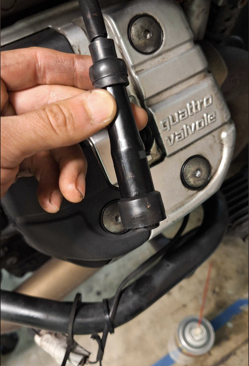

Kuni0 Posted January 15 Author Posted January 15 Ordered a new set of plug caps. I'll report back on the results. Regardless, it's a good opportunity to learn my bike more. It is funny that a bike that I consider I know so well throws me something out of left field, and one so well documented at that. (at least I haven't touched the 'sacred screw' in all of my meddling) 2

pete roper Posted January 16 Posted January 16 17 hours ago, gstallons said: I have some NOS (old) Champion and NGK caps I inherited from a friend and have them laying around here. You can get them from any good bike shop . As I said. NGK have ceased production. The end! No more! Any at any shop will be NOS. I don’t know about Champion. 1 1
gstallons Posted January 16 Posted January 16 The NGK caps are a part # LB05F . I think I put them on my red frame after dropping it in the Waffle Hut parking lot.

Kuni0 Posted January 21 Author Posted January 21 I'm back with a report, and unfortunately, the new plug c aps didn't do the trick. I tried a couple of times with my battery booster, and still no dice. 1
