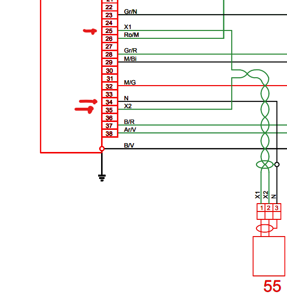

Pressureangle Posted January 21 Posted January 21 2 hours ago, Kuni0 said: I performed the test in this video here (start of the test at 2:00 timepoint). Even though it's for a car, I don't see how it'll be much different for a motorcycle. Instead of seeing 5V for the high and low signal, I saw 2.5 and 1.5 V. I tested the ground per the procedure in the video and got exactly 12.6V That sounds to me like you're going to have to resign yourself to 'search and destroy' mode. Every connector in every relevant circuit needs to be inspected and cleaned (Kaig DeOxit, aerosol on Amazon) I like to start from easy, working as necessary to hard; the suggestion to drain the fuel is not a bad one. I had enough water collecting in the injection hoses/barbs to give me fits a couple seasons ago. But since you know you have a voltage issue, the only thing remaining is to find the poor connection, or prove the ECU to be the problem by the test above- it isn't clear if your low voltages are at the sensors or actually at the ECU pin. Sometimes it be like that. Do you have a good clear schematic of the wiring for your particular bike? 2
Kuni0 Posted January 22 Author Posted January 22 This is the schematic that I've been using. It's for a 2012 Stelvio. Thankfully it's a very direct connection to the ecu. 55 is the cam position sensor I believe (it's labelled as 'Pick-up' sensor) 2 hours ago, pete roper said: Any odd behaviour from the dashboard? Does it blank out when the engine is cranking? The dashboard blanks out sometimes when the engine is cranking, but not 100%. The big "SERVICE" sign pops up sometimes, but again not 100% when I turn on the ignition. Bad gas was put as an option, but I'm doubtful of that since I filled up at the same gas station as my girlfriend and she had no issues with her bike (Yamaha MT-07) on the same gas. Regardless, draining the old gas and putting new in should probably be on the list of things to do at this point. (no-ethanol gas isn't an option here in California really unfortunately)

Kuni0 Posted March 17 Author Posted March 17 Sorry about the delay. I needed to take a break from working on the Stelvio and work on other projects that weren't being attended too. I may be jinxing myself, but I got the Stelvio running again! Turns out it was a situation of occam's razor, it was the battery gone bad. Put in a new battery, cleared the fault codes in the ECU, sprayed some carb cleaner in the intake to help it get going and it fired right up! Hindsight being 20/20, I should have known that multiple, random errors showing up was likely a battery issue as Pete said, but I got fixated on the camshaft sensor since it did fail in the past. I've put ~400 miles on it at this point and have had no further issues develop 4
