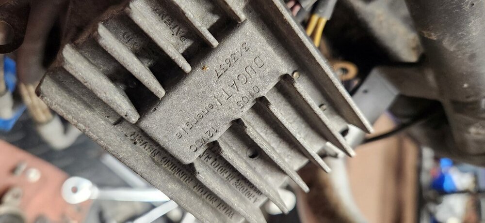

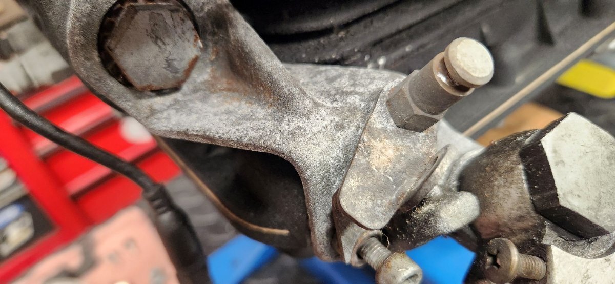

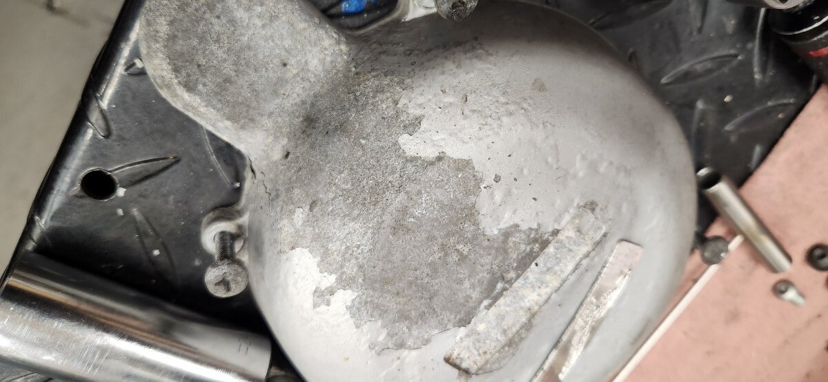

Steve Swan Posted Tuesday at 06:32 AM Posted Tuesday at 06:32 AM (edited) I joined up with this great forum last July not long after i purchased this '02 Lemans, upon receipt, it became rather obvious the p.o. did not take care of it, so other than fluids change, its sat since and because the totally unexpected happened, i became a car guy, bought a gorgeous '94 Corvette, i am really digging the car and have been intoxicated by it, doing a bunch of routine stuff a 31 year old car needs so it's summer ready, my other car is a '96 Geo Metro, i've never owned a car even remotely similar to the Vette. So... back to my LeMans. The bike came form Michigan, was very obviously ridden in salt, likely never cleaned nor maintained much at all, i'll post pics, this will be a bit of running thread as i bring this poor old soul back to life. Very sad, beyond my comprehension how someone can treat a bike like a piece of shit. So, i'll have some questions along my merry way. Here are pics of the salt damage, major pitting in alt.cover and side stand. Scattered rust through out. Next are basically 3 electrical curiosities, i am guessing the p.o. had his hands on this... has a Ducati regulator, would the factory be sending out a LeMans with Duc parts on it? Edited Tuesday at 06:42 AM by Steve Swan 2

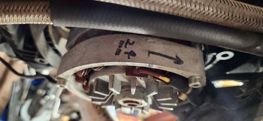

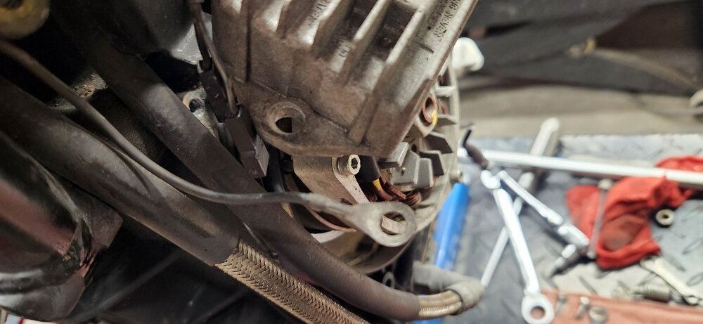

Steve Swan Posted Tuesday at 06:44 AM Author Posted Tuesday at 06:44 AM (edited) Next, markings on the alternator frame, 24...? degrees...? What do you think? And, then lastly, this unattached wire dangling loose wire, a ground...? i don't seen anywhere near by the wire could atach to. Any thoughts where it attaches? Probably difficult to know, until i remove the tank. When i last rode the bike, i siphoned out what ethanol i could and put in corn-free. Once i remove the tank, am i at risk for it growing larger, creating a challenge upon reinstall? Gotta remove it as i am give the old rode-hard-and-put-away-wet gal a thorough servicing and cleaning and refinish finishes on rust-damaged parts. Not going spending-money-nuts, but it will be cleaned up and roadworthy when i'm finished. What ever the mufflers are, they have the worst god-awful sound, they are literally raspy, nothing deep like my '00 Greenie was. So i have round satin Mistrals ordered, but that's gonna be my only big dollar expenditure for the time being. The bike only has 12k miles on odo. it came with nice items, lowered, adjustable driver pegs, shift, brake pedals, 2 sets of Givi bags, top rack with luggage case. I am saving the bike from an early demise. Wasn't in my playbook to get into another deep-ish project, but at least i'll know what's between my legs and under my butt come riding season. I very much welcome your thoughts. Thank you so much for your time and help. Edited Tuesday at 07:03 AM by Steve Swan 1
gstallons Posted Tuesday at 11:34 AM Posted Tuesday at 11:34 AM Whew......it looks like that thing was parked o/s and by a shed ! I will have a look and see where the - wire should be attached . I would think the owner installed a Ducati V/R . Don't worry about it. The magic marker stuff on the alternator , IKD. BTW leave the fuel tank open and it will return to normal . If it is hard to reinstall , you can pare down the rubber pucks at the front until they accept the tank . about 120 degrees of grinding is all you need . 1
docc Posted Tuesday at 02:33 PM Posted Tuesday at 02:33 PM The regulator is factory original. "Ducati Energia " is a different company than Ducati Mechanica that makes the motorcycles. The loose ring terminal is the factory ground for the regulator and goes under the missing mounting fastener for the regulator. Certainly run another, more robust, ground from the regulator case to the timing chest of the engine. The markings on the alternator show the direction to turn the crank to position at TDC for valve adjustment and the size of the socket to use on the crank nut (24 mm). Thanks for the running thread, @Steve Swan! Looking forward to watching and sharing in the progress! 3 2
4corsa Posted Tuesday at 02:53 PM Posted Tuesday at 02:53 PM For your alternator cover, I bought one of these carbon fiber versions, which appear to be on sale for $75 right now: https://mdicarbonfiber.com/products/ducati-moto_guzzi_1100_sport-alternator-cover 3

Steve Swan Posted Wednesday at 05:57 AM Author Posted Wednesday at 05:57 AM @docc @gstallons @4corsa @Scud Thank you gentlemen for sharing your knowledge. Yes, i plan to address the major service areas. It's going to be a process deciding on finishes. I am leaning to do as much of the finishes in my shop. More consideration required. i do know the bike is going to be a rider, and so in a way, i'm glad it's not going to be factory original perfect when i'm finished. Thanks for noting where that ground attaches. I've already cleaned the front calipers, the pistons move freely. The bike is red/grey and has some wounds, but nothing horrid. Thanks for clarifying https://www.ducatienergia.com/index.php?lang=en i figure i've got the months of February, March, April and most of May to get the bike roadworthy. Updates will follow. 2
Steve Swan Posted Wednesday at 06:49 AM Author Posted Wednesday at 06:49 AM Are there other Moto Guzzi models of which the alternator cover interchanges? I don't think i'm quite ready for a carbon fiber cover, but i guess i could paint it...
MartyNZ Posted Wednesday at 07:18 AM Posted Wednesday at 07:18 AM 22 minutes ago, Steve Swan said: I don't think i'm quite ready for a carbon fiber cover, but i guess i could paint it... You can paint the old cover. On mine I needed to fill and sand the pock marks caused by road grime, then you can do a good paint job with a rattle can. If you can't find or afford the eagle badge on the cover, then no one will notice that it is missing. 3
