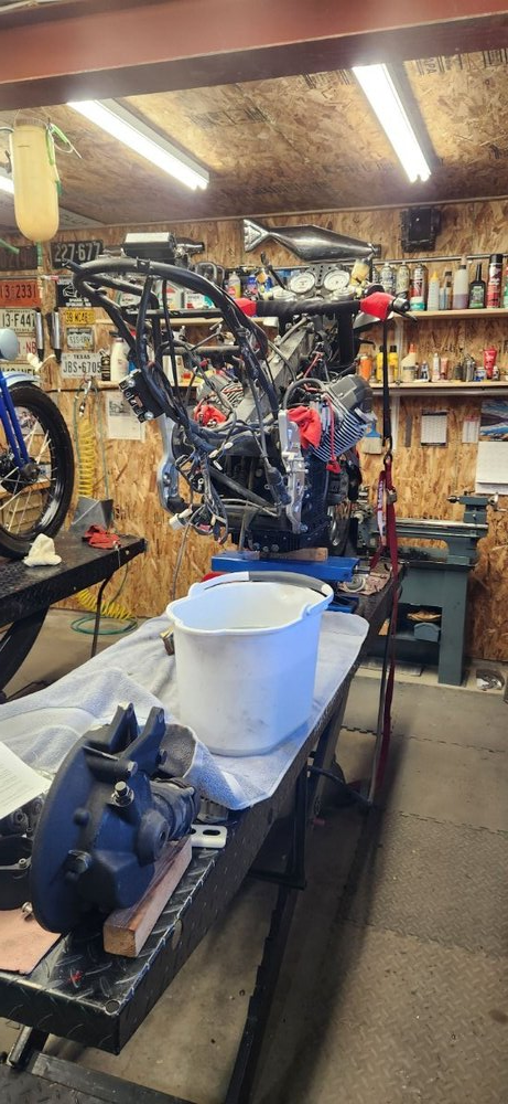

Steve Swan Posted February 26 Author Posted February 26 (edited) Today i gave the poor old sow a bed bath... first step to making at the least as faux silk purse... apology for siedeways pic, took the damn thing in vertical with camera phone, and rotated 90 degrees x's 4 to get it upright, ain't happenin' Edited February 26 by Steve Swan 1 1
audiomick Posted February 27 Posted February 27 23 hours ago, Steve Swan said: ... get it upright, ain't happenin' Get GIMP. 1
