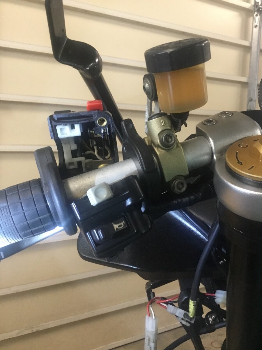

Tennitragic Posted Thursday at 07:22 AM Posted Thursday at 07:22 AM This latest niggle has me perplexed…my Tenni’s original headlight was a bit rusty and reflector scratched. Pilot light and high beam fine but low beam was not lighting. Replaced bulb - no low beam. New headlight arrived - no low beam. Checking left handlebar switch block as possible culprit, the horn button, indicators, passing switch all working. Flicking the light switch, position 1 pilot light fine, position 2 high beam only. Could the problem be the red high/low beam button? And here I thought was the fun part…with no key inserted/ignition off, low beam works when the light switch is moved to position 2, but nothing else is ‘live’! Any ideas or hints? Thanks.

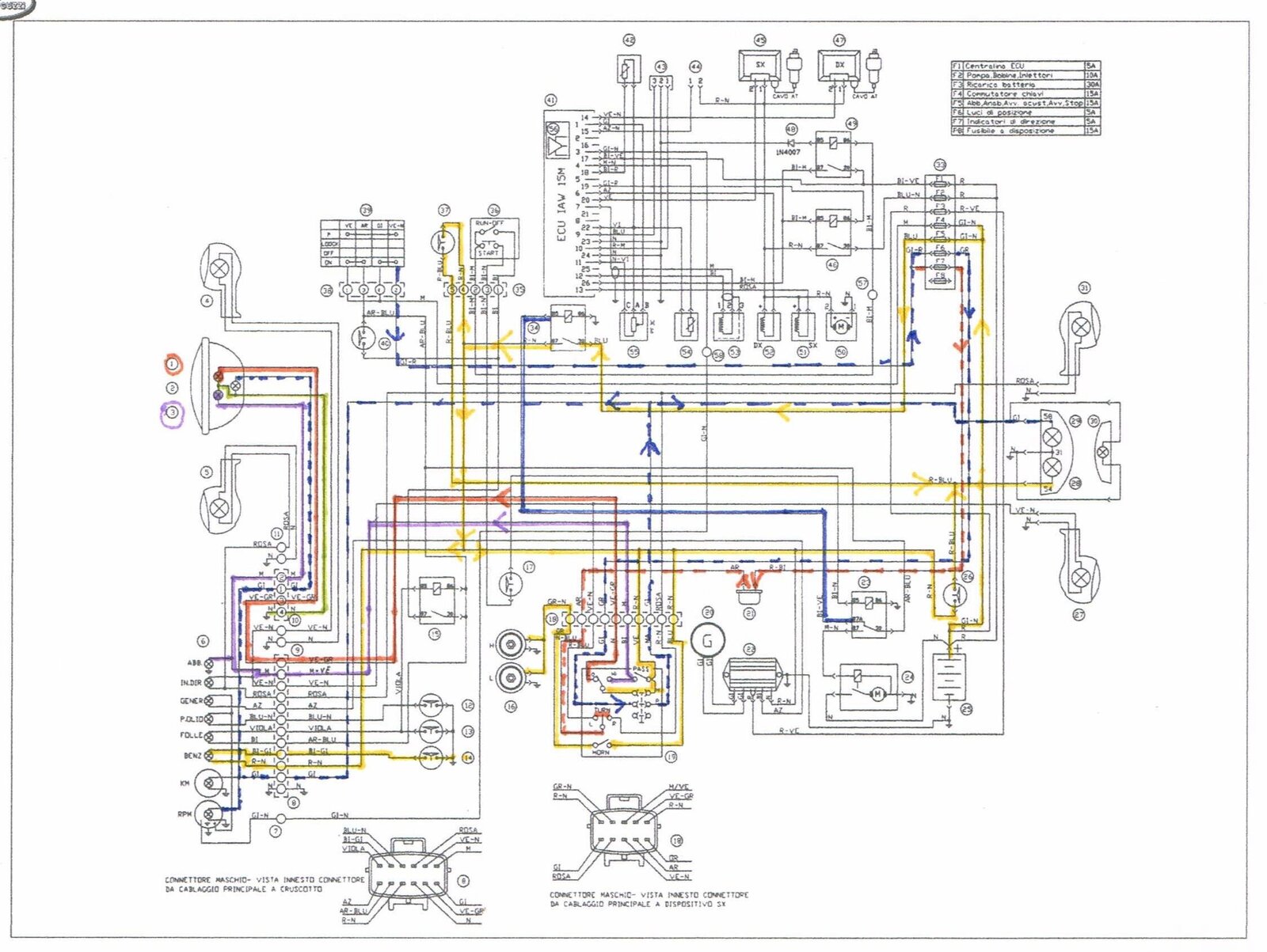

audiomick Posted Thursday at 10:55 PM Posted Thursday at 10:55 PM (edited) 4 hours ago, audiomick said: I've just spent an hour or so with a printed copy of the wiring diagram and coloured pens, For what it is worth, here is the result of that. The wiring diagram is on page 459 of this PDF, according to the document viewer https://guzzitek.org/gb/ma_us_uk/1100/V11_1999-2003_Atelier(Compil-GB-D-NL).pdf The legend is on the following page. Here is what I got. Maybe it will help someone. Edited Thursday at 10:57 PM by audiomick

Tennitragic Posted yesterday at 01:53 AM Author Posted yesterday at 01:53 AM Well, low beam as a term for impotence….you learn something new everyday….ha/ha! On to the real problem….! “Power is lost within the Bosch headlight relay” is this electrical novice’s answer so far. The multimeter showed 13 volts on the green/grey wire on the way in to the relay but registers zero on the relay pin on the way out. Photo 1. Am I on the right track here? Recalling the issue was only the low beam is not working with ignition on, headlight switch position 2 (with low beam selected on the red push button). Strangely low beam comes on when handlebar headlight switch moved to position 2 on but the ignition is off! Photo 3. Reading/learning on this forum..V11 original relays are a big issue. Here is a photo of the under seat relays…Photo 2. I have not touched these as yet… original thought was that bike was previously owned by more capable people than myself and ‘do not alter anything’. Unless the bike develops a problem ie low beam etc…then work on it/improve. PS Sorry about the poor photos..all too big apart from these three…a younger family member will need to show me how to reduce and properly attach/send!
