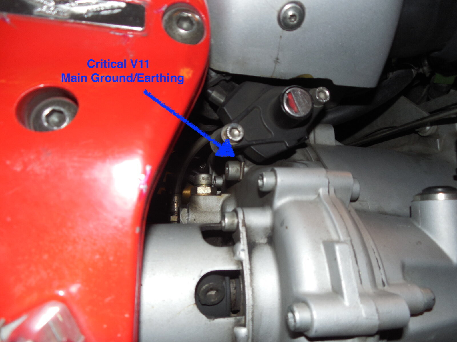

docc Posted February 13 Posted February 13 On 2/12/2025 at 2:45 PM, po18guy said: You have traced the battery ground cable to the transmission case and cleaned/tightened it? 34 minutes ago, LowRyter said: I suppose it's been mentioned that the ground should be inspected. The importance of the main ground from the battery to the back of the gearbox cannot be overemphasized . . . As well as the additional ground from the regulator case to the engine timing chest: 2 1
po18guy Posted February 14 Posted February 14 I have found over-zealous application of shrink wrap at both ends of the cable. Thus, it was making only partial contact, squishing the shrink wrap, which will continue to compress, slowly loosening the connection. Add in that Guzzi character (vibration), and it becomes a recipe for future consternation. 1
