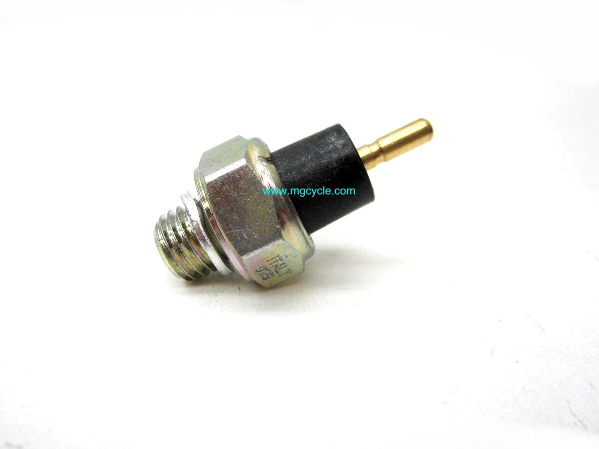

PhillipLarsen Posted 2 hours ago Posted 2 hours ago https://www.mgcycle.com/index.php?main_page=index&cPath=37_140 17768750 - $11.38 - Oil pressure switch most Guzzis thru 2005 GU17768750 [17768750] : MG Cycle, Moto Guzzi Parts and Accessories available online at MGCycle.com 1 1
audiomick Posted 2 hours ago Posted 2 hours ago (edited) 12 minutes ago, PhillipLarsen said: 17768750 - $11.38 - Oil pressure switch most Guzzis thru 2005 GU17768750 [17768750] : MG Cycle, Moto Guzzi Parts and Accessories available online at MGCycle.com Following that link, I found this under "related products": Quote Superseding GU31768780 and 978854. Oil pressure switch for Nevada Club, Breva 1100, Breva 1200, Griso 1100, Griso 1200 8V 2009 to 2014, Sport 1200, Norge 2006 to 2016, Stelvio 2007 to 2011, 1200 Sport 8V, Bellagio. Thread diameter is 12mm on this item, thread pitch is 1.5. https://www.mgcycle.com/index.php?main_page=product_info&products_id=2387 that looks remarkably similar to the "Fiat tractor" part I linked further up maybe we're onto something here... PS: I searched for the part numbers at Stein-Dinse and got these https://www.stein-dinse.com/de/search.html?grp=&searchStr=31768780 https://www.stein-dinse.com/de/search.html?grp=&searchStr=978854 so apparently there are more than one alternatives out there. Edited 2 hours ago by audiomick
docc Posted 2 hours ago Posted 2 hours ago My 2000 Sport definitely has the "bullet" connector as shown by @PhillipLarsen, not the "spade connector. 1
audiomick Posted 1 hour ago Posted 1 hour ago (edited) 19 minutes ago, docc said: My 2000 Sport definitely has the "bullet" connector as shown by @PhillipLarsen, not the "spade connector. Yes, and of course that would be the best solution. Saves altering the wiring. But if that part is not available or should become not available... Edited 1 hour ago by audiomick 1
