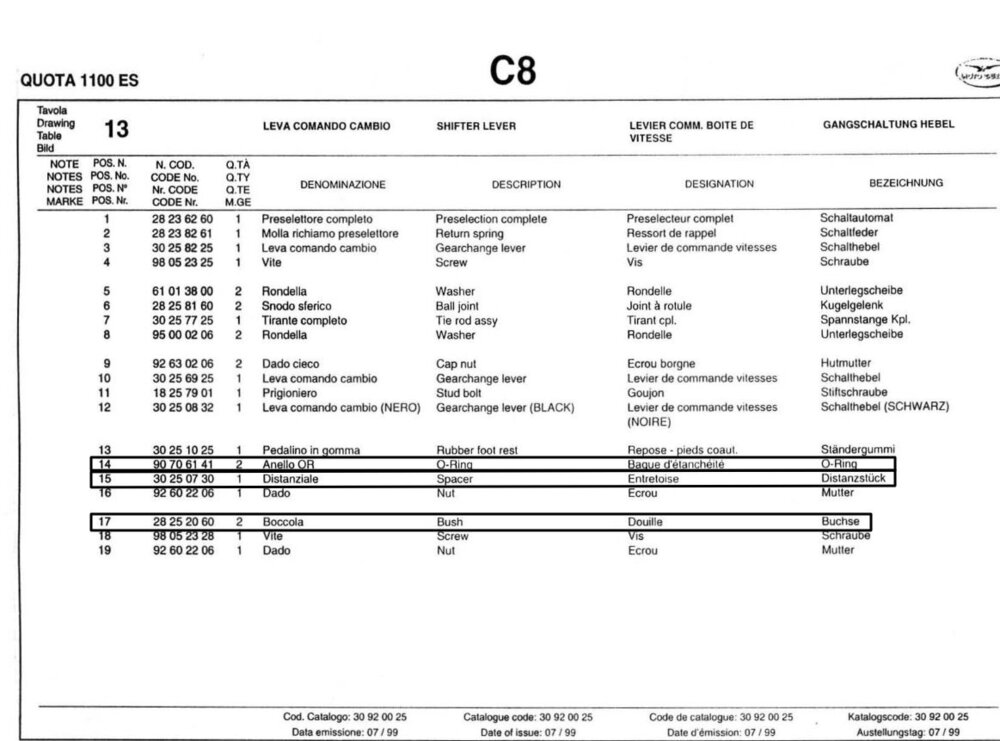

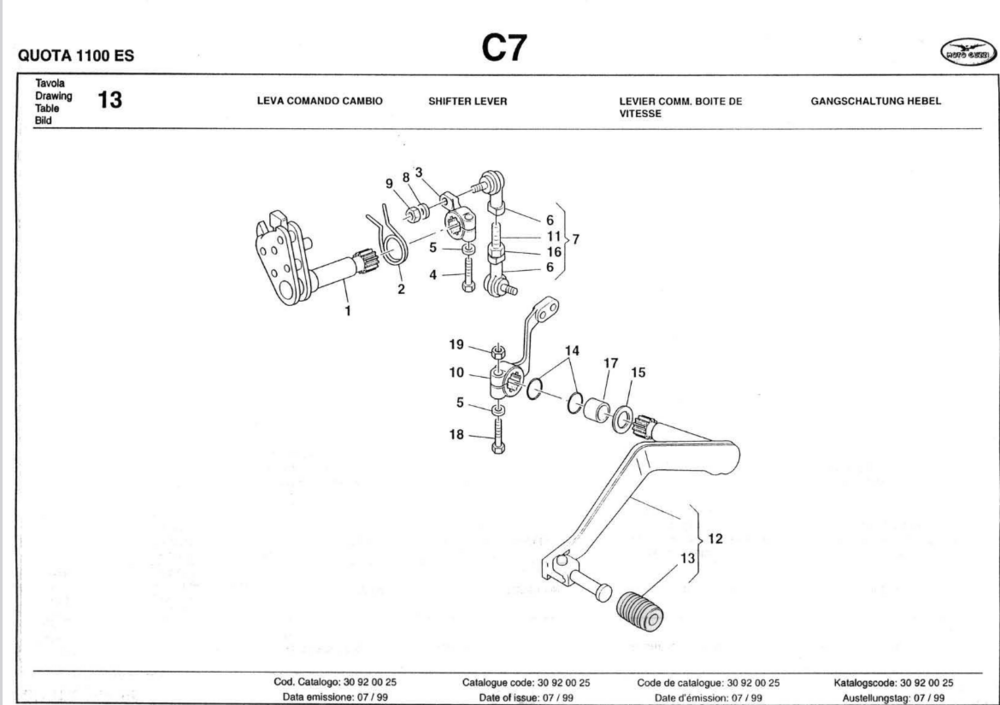

Here's the drawing of the gear selection mechanism:
I have now had twice the shift lever item 12 coming off item 10 gear selection lever.
o'ring items #14 is what limits the lateral movement of the shift lever item 12.
I believe I am missing the spacer #15 and bushing insert #17 that keeps the first o'ring in place. The axe of the shift lever has two grooves in which the o'ring sit. In my situation, there is a 7mm lateral play, and with repeat gear changes, get the shift lever off the gear selection lever. The spline holder eventually gets out.

If anybody knows someone who possess a Quota, please ask if they can give me the dimensions of item 17 and 15. For item 15, I should be able to find a washer here in the USA. For item 17, it would need to be a precise measurement, given that it goes around the selector axe and inside the sleeve that holds it.
I don't think I could find it so I will need to have it manufactured.
The description in the Parts Catalogue sometimes specifies dimensions, especially for items like that washer.
What are the Moto Guzzi part numbers of the two items?
If it is a spring there, take it of. Just a washer. Probably hard to take picture from underneath, to see whats missing. Stainless pipe in correct dim shoud'nt be to hard to find. The lever shoud be sitting fine in the frame bracket, #17 is just taking up the play. Just my thoughts.

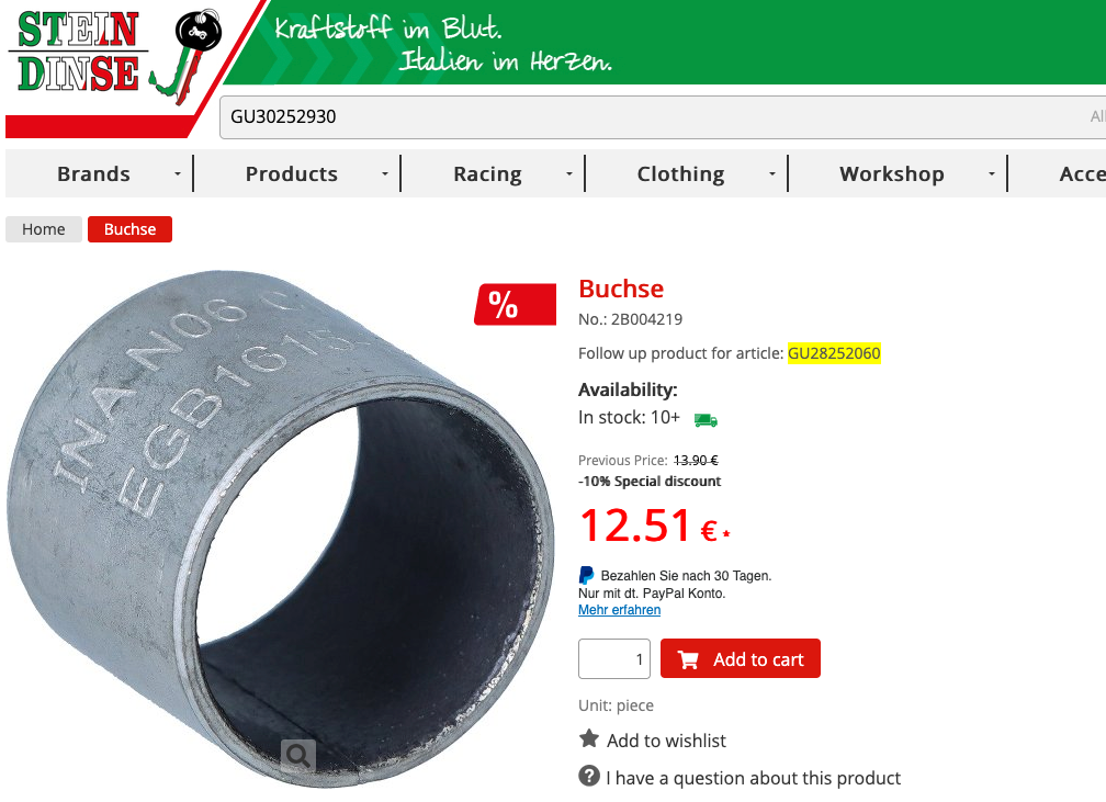

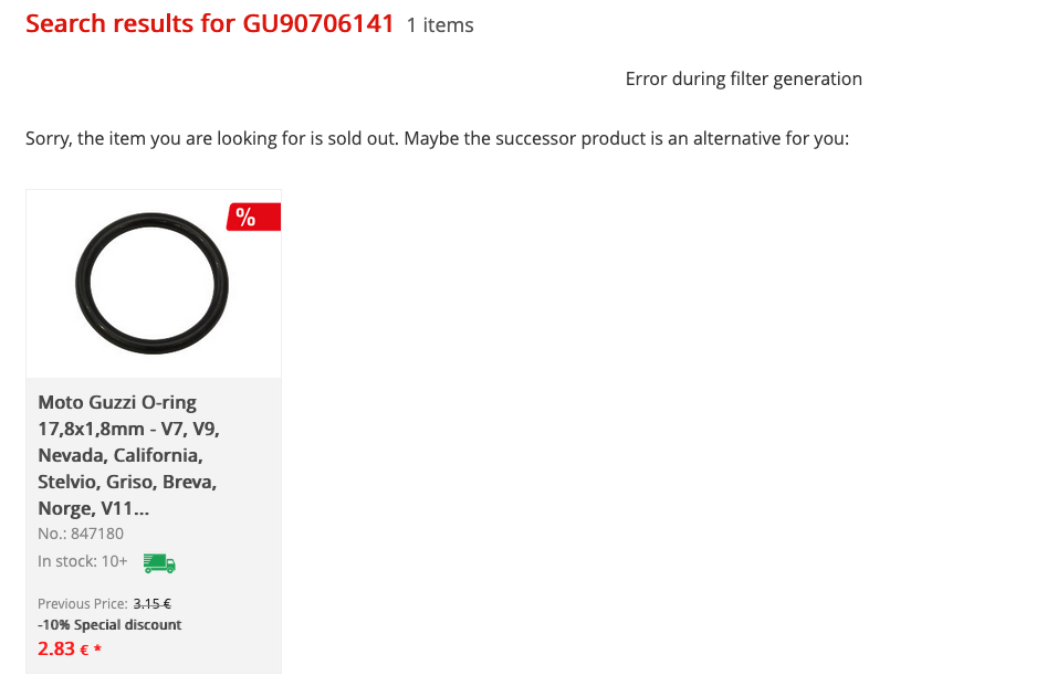

I checked Stein Dinse; item GU90706141, GU28252060 are out of stock, but they list an alternative. I am not sure if the alternatives fits.
GU30250730 is out of stock and without any alternative.
See below the Stein Dinse search and the Leva commando cambio nomenclature page.

I believe the two o'rings are what limit the lateral movement. The gear shift lever axe has a groove that I could see. There are two bushings indicated in the nomenclature, only one shown on the drawing. I believe both o'rings are separated by a bushing, and the spacer prevents the assembly to move laterally using the o'rings as stops. It seems difficult to understand why the o'rings should be used to limit the lateral movement, since they wear out.
There should not be a 7mm play, and the splined end of the gear lever is currently what prevents the shift lever to fall out but it is not designed for that..

Std bush. Buy them anywhere for far less.
https://www.sp-spareparts.com/en/p/egb-1615-e40-b-ina?srsltid=AfmBOopEQweX5noDan8IK06-n8jMwp2x23nsWgj79duzIrKvL2X86Efe

I found a gear shifter lever for sale on eBay, and it seems to have an identical spring washer as on mine. So perhaps this is what is referenced as item #15.
I found both missing items available from AF1racing.com. 1 o'ring for 4.04 USD!!!
I am going to check if the Stein Dinse dimension is a match ID=17.8mm and CS=1.8mm, and order a bag from Parker.

The gear lever morse around the spline of the shift lever is clamped using that nylstop nut. But this is to make sure the spline are locked to transmit the rotational movement. Mechanically, this is not a lateral grip.
If I had a pedestal drill, I would drill the center of the shif lever on the spline end, thread it, and install a hex head screw with a flat washer larger than the gear lever morse. This would guarantee any futher disconnect. My current understanding, from just looking at the drawing, is that the o'rings are what prevents lateral movements. I believe they are installed in between the two bushings, item #17.  If you look at the picture of the selector in my previous post, you can see the surface where the bushings are in between the shift lever and the sleeve that holds it. I need to find out where those o'ings are supposed to go. I do not seen any other reason for having o'rings there, do you?
I found this supplier in Virginia: each o'ring is 0.05$ I still need to ascertain that this is the correct size. They seem to have all the o'ring in metric sizes, so it maybe worth keeping the supplier handy.
https://www.oringsandmore.com/metric-buna-o-rings-17-8-x-1-8mm-minimum-20-pcs/
IF this shifter assy. is on the bike and is working condition, move the shift lever up and down and verify the foot lever and the lever inside the frame have no slack and this is tight . Morse = ? are you referring to the splines ?
 These 0-rings are nothing more than dust shields to keep out "bad stuff" and the wave washer or spring keeps the side (in & out) motion to a minimum . IDK how thick this frame tube is where the shift shaft goes through. I drilled / tapped the shift lever (not the frame) on the red frame for a grease fitting to keep the shift lever happy. You will have to see what you have to work with and decide if you can do this .
