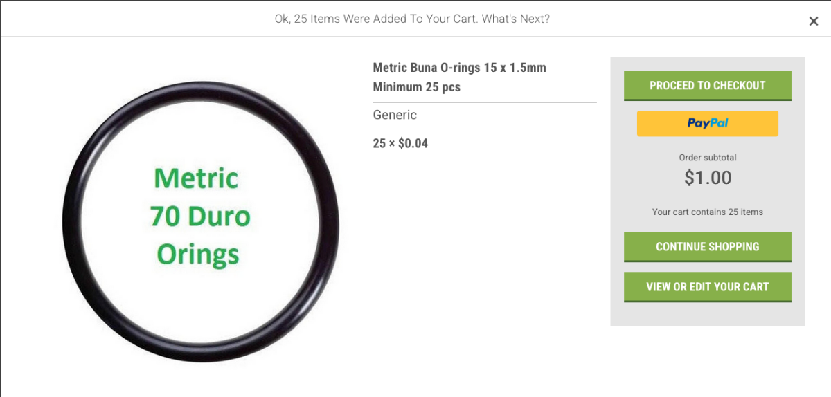

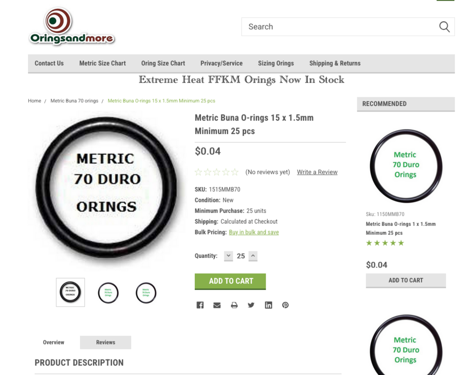

p6x Posted Thursday at 06:16 PM Author Posted Thursday at 06:16 PM (edited) I received the o'rings this morning: The size is ID=15mm x CS=1.5mm. Therefore, any O'ring GU90706141 is it; I paid 18 dollars for two o'rings.... Edited Thursday at 06:18 PM by p6x
