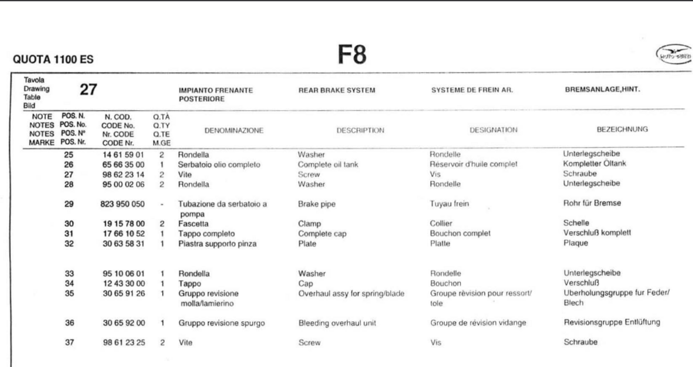

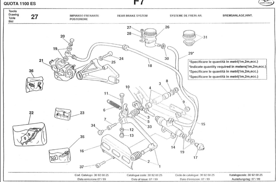

p6x Posted March 17 Author Posted March 17 2 hours ago, gstallons said: Wha are the part #s of the washers ? This is the problem with not giving your customers the technical definition of a generic part. On the drawing it is item #25; listed as "washer" with Guzzi part number. Instead, it should read: M8 lock washer for socket head screw. Guzzi does not manufacure that part.
gstallons Posted March 17 Posted March 17 That is a Schnorr washer , you can get it through a local fastener store if you don't want to spend the $$ on UPS or FedEx charges.... what ever you want to do . I may have some in my stuff. Finding them will be a little chore 2

p6x Posted March 17 Author Posted March 17 (edited) 2 hours ago, gstallons said: Schnorr washer Thanks for giving a brand name to this type of washer. By looking it up, I found that the technical appellation is Serrated Safety Washer. 2 hours ago, gstallons said: you can get it through a local fastener store if you don't want to spend the $$ on UPS or FedEx charges It seems not. This is simply incredible that a 0.05$ item costs you up to 50$ with the transport. I am going to make a shopping list of the flowing supplies I need and get all that from France on my next trip. Found them on Amazon, for 11$; they are not the flat type but conical but I am going to get 100 of them for that price. McMaster-Car was 13$ for 5 item + transport at my expense. Edited March 17 by p6x
