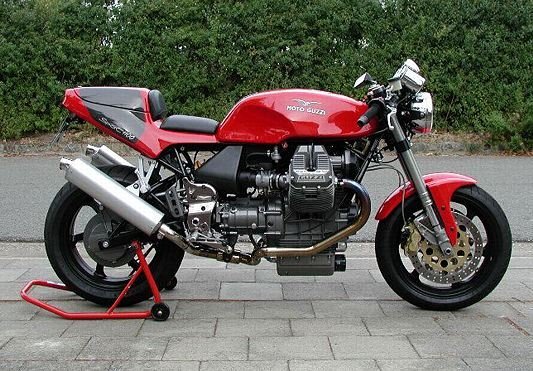

audiomick Posted Saturday at 12:24 AM Posted Saturday at 12:24 AM (edited) I gather the package, motor, suspension, brakes, is very good, even verging on excellent. The few times I've seen one in the flesh, my reaction ranged all the way from "what the fark is that?" to "hmm, actually not bad". But if I had one, it would have to be modified. A German company made a thing that they named "Scandalo". A Centauro with (I think) a Sport 1100 tank and a seat and tailpiece that they made themselves. Looks a lot like the photo that @Lucky Phil posted further up. If I had one, it would have to go a long way in that direction to make me happy, but of course with clip-ons instead of that silly chook-chaser handlebar. Here, a picture of a Scandalo stolen out of the internet Edited Saturday at 12:31 AM by audiomick 2

Lucky Phil Posted Saturday at 01:03 AM Posted Saturday at 01:03 AM (edited) On 3/29/2025 at 12:24 AM, audiomick said: I gather the package, motor, suspension, brakes, is very good, even verging on excellent. The few times I've seen one in the flesh, my reaction ranged all the way from "what the fark is that?" to "hmm, actually not bad". But if I had one, it would have to be modified. A German company made a thing that they named "Scandalo". A Centauro with (I think) a Sport 1100 tank and a seat and tailpiece that they made themselves. Looks a lot like the photo that @Lucky Phil posted further up. If I had one, it would have to go a long way in that direction to make me happy, but of course with clip-ons instead of that silly chook-chaser handlebar. Here, a picture of a Scandalo stolen out of the internet Expand Elegant. Sensible airbox Phil Edited Saturday at 01:05 AM by Lucky Phil 5
Weegie Posted Saturday at 12:31 PM Posted Saturday at 12:31 PM (edited) Interesting that it has a MotoSpezial V Sump (Guzziladen was still selling these last I heard) Installing one onto a Broadsump isn't straightforward and unless provision is made for an oil cooler, of doubtful gain in cooling. Paul Minnaert is the only guy who installed one onto a Daytona that I knew of, but there are obviously more out there Paul installed a cooler using a sandwich plate behind the oil filter to feed a cooler. I thought about a similar setup but the deepsump wouldn't fit as mine has a bellypan. Suppose the external filter is a gain and the Vee reduces the chance of pump pickup starvation, but a Roper Plate does much the same thing. @HadaDaytona are you going for a US Daytona RS? I think the US Daytona RS and the Centi engines are the same. European bikes got "absolutely mad" C kit cams which make them enormous fun, but they run hot (100 C in free air) and overheat very quickly in traffic. More suited to a track than the road. EDIT For clarity the C kit cams were only installed to the Daytona RS exceptions being Dayona RS imported to Switzerland, Singapore and the US. The exceptions had the original Daytona cams. The Centauros sold everywhere had the original Daytona cams too. Edited Saturday at 02:08 PM by Weegie Clarification 2
Pressureangle Posted Saturday at 03:31 PM Posted Saturday at 03:31 PM On 3/29/2025 at 1:03 AM, Lucky Phil said: Elegant. Sensible airbox Phil Expand Is that the same tail piece as the green one posted above? Perhaps it's the angle of the photo that makes the green one look like a frog's butt? This one is so close but so much better.
