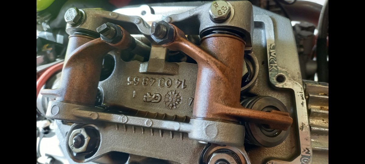

Molly Posted Sunday at 08:41 AM Posted Sunday at 08:41 AM Sorry guys. After help again... Doing clearances. Right side. D marker showing. Piston crown visible. No play in rockers. Backed off completely. Still no play. Any thoughts? Thanks in advance. Do appreciate your help. 1
Lucky Phil Posted Sunday at 08:48 AM Posted Sunday at 08:48 AM 3 minutes ago, Molly said: Sorry guys. After help again... Doing clearances. Right side. D marker showing. Piston crown visible. No play in rockers. Backed off completely. Still no play. Any thoughts? Thanks in advance. Do appreciate your help. You're trying to set the clearances on the overlap. Turn it another 360 degrees. Phil 7 1

gstallons Posted Monday at 08:03 PM Posted Monday at 08:03 PM I am sure Phil was giving Molly the best/correct diagnosis , he was trying to adjust the valves on the valve overlap stroke instead of the ignition stroke. 1 1
