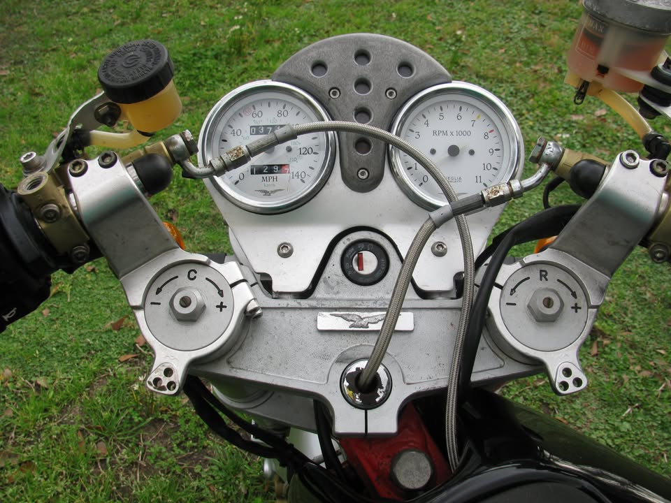

audiomick Posted 23 hours ago Posted 23 hours ago I see the clip-ons have been moved to above the triple-clamps. Has he just pushed the forks up to do that, or changed them? 1
Tomchri Posted 23 hours ago Posted 23 hours ago Looks like it. Bet she is a little nervous in low speed. Comparing to what happened to my Greenie with different tripple clamps a few days ago. Cheers Tom. 2
audiomick Posted 22 hours ago Posted 22 hours ago (edited) 21 minutes ago, Tomchri said: Looks like it. Just pushed the forks up you mean? Yeah, I think so too. This picture from the facebook advert shows forks that appear to have compression damping in the left leg, and rebound in the right. As far as I know, that would be the 40 mm forks from the earliest models with the clip-ons under the triple-clamps, wouldn't it? Edited 22 hours ago by audiomick 1 1
Tomchri Posted 22 hours ago Posted 22 hours ago 4 minutes ago, audiomick said: Just pushed the forks up you mean? Yeah, I think so too. This picture shows forks that appear to have compression damping in the left leg, and rebound in the right. As far as I know, that would be the 40 mm forks from the earliest models with the clip-ons und the triple-clamps, wouldn't it? Yes. A bit special routing for hoses,wiring me think. Cheers Tom. 1
audiomick Posted 22 hours ago Posted 22 hours ago 16 minutes ago, Tomchri said: ...A bit special routing for hoses,wiring me think... "Rough as guts" was my thought on that... 2 1

mikev Posted 9 hours ago Posted 9 hours ago It looks to me like the front end has been rebuilt/repaired from parts, silver wheel fender, prior fork comments, so maybe has a crash history. 1
gstallons Posted 7 hours ago Posted 7 hours ago I sure don't like the way those hydraulic lines are routed . That looks pretty sad.
Tomchri Posted 1 hour ago Posted 1 hour ago 20 hours ago, audiomick said: "Rough as guts" was my thought on that... Just beeing polite. What I realy meant . Cheers Tom.
