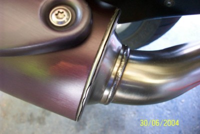

Guest Brian Robson Posted July 1, 2004 Posted July 1, 2004 30,000 miles has hit with a little vengance. The timing gasket leaked, now its replaced. The bevel box bearing went south, now it is also fixed. Sunny day here in Lotusland, wheel in place, bike washed and during drying I noticed that the right hand tailpipe has a circumferential crack in front of the heel plate, not in the aluminium cover but next to the ridge of stainless. Obviously all the way through as this was where the exhaust gas chose to exit. Kudos to British Italian MC as they have lent me a pair of silver V11 pipes while they handle the warranty (14 months into it). They have a set of Ti pipes and may ask MG if I can pay the difference. Relatively high mileage may have some advantages as this might have occurred after the two year period. With other bikes this may well have irritated me (especially as Baldini calls me Mr Angry ), but it only confirms that this is a bike with foibles, and I have nothing but good to say how both MG and my local dealers act upon any issues. Anyhoo, check your pipes.
Guest Brian Robson Posted July 1, 2004 Posted July 1, 2004 Hopefully my first attempt at a photo worked

droydx Posted July 1, 2004 Posted July 1, 2004 My left side head pipe cracked along the down bend with under 1000 miles on it. Currently being replaced under warranty. I welded up the crack so I could ride it while the boat is coming over from Italy with my pipe and gaskets.

Steve G. Posted July 1, 2004 Posted July 1, 2004 Hi Brian, It's pretty clear to me this is another vibration related thing, and I've seen vibration related stuff happen on all bikes of every origin. Ciao, Steve G.

Ballacraine Posted July 15, 2004 Posted July 15, 2004 Hi Brian, It's pretty clear to me this is another vibration related thing, and I've seen vibration related stuff happen on all bikes of every origin. Ciao, Steve G. My thoughts exactly! Probably due to one mount being more rigid / tighter than another. Or maybe in some cases down to poor design of the mounts. In this case I would guess probably the former. You will get a stress / fatigue failure just like that. Nige.
