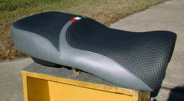

RichMaund Posted November 18, 2002 Posted November 18, 2002 Dense closed cell foam tape works well to pad it there too. I think they all rub there. Here's a picture of the two-up Lemans seat I shipped today. The new owner will have it tomorrow and we'll see how he likes it! Sorry. I just had to show it off. It was a great project!
al_roethlisberger Posted November 18, 2002 Posted November 18, 2002 Looks great Rich... as usual What I'd really like to see though, is how it looks installed. Maybe the new owner will grace us with some before and after photos! al
jrt Posted November 18, 2002 Posted November 18, 2002 Hi Al, There's two 'kind of small' pics on my website of my V11 with Rich's seat. Gawd, my English teacher would kill me for that last sentance... Anyhow- I replaced the seat by the time I took the pics of my bike with the mistral mufflers attached. One has the cowling on it. http://plasterbath.chem.uiowa.edu/fairing.html The fit is excellent. The seat is also a lot more comfortable now that Rich re-covered it. I specifically wanted to be able to put the cowling back on- as I recall, Rich can do it either way, although the 'with cowling' style is less comfortable for the passenger (wouldn't know about that part I could post a couple of bigger pics if you're really interested. Cheers, Jason
Guest Squashed Nose Posted November 19, 2002 Posted November 19, 2002 jrt, your English teacher (along with me) would probably kill you for spelling sentence, 'sentance' as well. Rich, that seat is a stunner. I love the Italian flag in the middle. I thought the Corbin jobbies were nice! You're an artist. I want one. How much? How long? Odd, don't you think? Since I've owned a V11 Le Mans, I've not seen another one and yet I want to customise the one I've got to make it look different from the rest!
Guest russ Posted November 19, 2002 Posted November 19, 2002 Rich and Al, I am the owner and I will be more than happy to grace the pages w/pic (and evaluation) this week! It looks awesome and I can't wait to try it out. I will also be posting the Verlicchi Clips review as well. Jeez, I just spent alot of money getting the LeMans just right, but still alot less than one of those German Uboats I used to ride.
