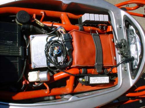

RichMaund Posted November 18, 2002 Share Posted November 18, 2002 Folks I installed the PC III this weekend. Easy job. About 20 minutes. Most of that was spent finding a good way to place the plug for the wiring so it didn't hit the pan. Placing it aft of the bikes computer next to the tool pouch and coiling the extra cable in a circle atop the computer worked really well and looks neat too. The PCIII itself resides in the tail piece. Plenty of room there. It rained all weekend though, so today was the first ride. I got a nice 20 mile ride in this morning with the new PCIII in my V11S. Here's my seat of the pants impression: First off I noticed it raised my idle speed when the engine warmed up. It went up a full 100 rpm. So I lowered it back to 1200 rpm. Riding around town. Drivability is a notch better. No more occasional cough at long lights when idling. Ran well and felt good. Heavy traffic though. I couldn't "play" too much. After I FedEx'd the seat I needed to ship I went out on the freeway and went to my favorite cloverleaf ramps. Impression. Noticeably stronger all the way up. No more "rush" as it hits 5K rpm because it is pulling stronger in the 4's. Throttle response is more linear. Now it's a nice even ride to yellow line vice the dip & rush that used to be there. Feels stronger up top. I missed the rush at first, until I realized that I was accelerating better w/o it due to the bike pulling stronger across the whole powerband. I tried some roll on passing with the engine at 4K rpm. It used to feel doggy there before and I would sometimes have to downshift to pass someone quickly. Now it pulls stronger from 4k as I roll on the throttle. No downshift needed. I can get really used to this! The PCIII was set up for my bike running the stock airfilter & box but with Mistral pipes and stock cross-over. But I have not had it dyno tuned to personalize it optimally for my bike yet. But my seat of the pants impression is that the bike runs much better. Right now my feeling is that even if I don't get it dyno tuned to finish optimizing the mapping, I can be very happy with the way it is presently! I plan to do before & after dyno pulls tomorrow at the local Triumph shop. One with the PCIII plugged in and one w/o it. We'll see if my "pants seat" is accurate or if I'm full of it. Stay tuned! ;-) Attached is a pic of the way I routed the cable and plug. You have to place the plug where it won't get crushed by the seat pan. On the aft end of the computer by the tool pouch worked well. Link to comment Share on other sites More sharing options...
Guest Squashed Nose Posted November 19, 2002 Share Posted November 19, 2002 Is that a custom tool pouch you've made yourself? I've only got a nasty cheap red nylon jobbie. I'll have one of those as well please. Link to comment Share on other sites More sharing options...
RichMaund Posted November 19, 2002 Author Share Posted November 19, 2002 I have one left. It is made from thick black leather vice red. No more material in the shop to make more. Sorry. Until demand warrants it, I can't just afford another hide. That's a big investment in materials! Link to comment Share on other sites More sharing options...

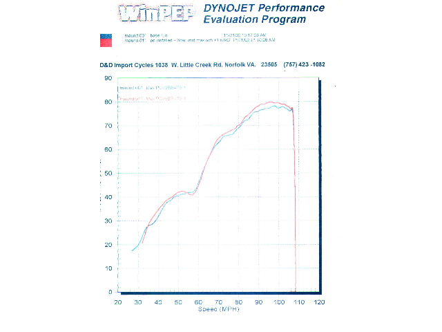

RichMaund Posted November 21, 2002 Author Share Posted November 21, 2002 Here's a HP vs Speed graph from my dyno runs this morning. Unfortunately the equipment there is older. They have no way to kook up to the PCIII. But it gave me a good idea of what's going on. The dip in the 4's is still there , but narrower. Picked up about 2 Hp and 2 ftlbs torque almost everywhere except in the dreaded 4.5K rpm range. The air-fuel ratio readings were really screwed up though. Made me wonder if their sniffer was OK. Off the chart lean in the midrange! The headers should have been cherry red according to their sniffer, but the bike ran great and never overheated at all. We richen'd it, but the bike felt weaker afterwards in the 4's. I'll put that adjustment back to where it was. My overall assessment? Worth the money. Driveability is much improved and the bike is stronger to boot. But I need to go somewhere like FBF to get it done properly on up to date equipment. Probably some more to be gained in efficiancy if I do that! So I am very happy with it so far. My two hours on the dyno there weren't wasted, but I need to go to a better facility to do it right! Link to comment Share on other sites More sharing options...
dlaing Posted November 21, 2002 Share Posted November 21, 2002 Not bad...I guess Todd Eagan talked to you about the wonders of "tuning link". Even with the tuning link setup, I would not be suprised if the dreaded 4500rpm hole is not really properly addressed by the PCIII. Our stock crossovers appear to be the cause of the hole. I assume that the crossover is making one of the cylinders work harder at that rpm. The result being that one cylinder probably reads rich and one lean at that point. Solution: get the Stucchi crossover. I have also considered eliminating the crossover and putting on some nice low mufflers like on more traditional guzzis. I might loose some top end power doing that, but the cylinders may become better balanced. This inspires me to post a question about cylinder balancing... Link to comment Share on other sites More sharing options...
RichMaund Posted November 22, 2002 Author Share Posted November 22, 2002 Folks It really bothered me that the bike gave such odd air fuel ratio readings on the dyno. Off scale lean at midrange and wavy, but acceptable in the low and hi range. Todd and I figured it was because the tail pipe sniffer only goes about 12" into the muffler in this dyno. Reading upstream of the cross-over would be better. But it seemed to read OK hi and low. What gives? I believe I found it.... The right intake boot has a crack in it on the inboard side. Just a narrow clean little crack that's almost hidden by the clamp. Where does the engine vibrate the most? Midrange! What is the likely cause of the crack opening up enough to lean out the AFR in the midrange? Engine vibration. Just enough to throw the whole thing off w/o really affecting drivability yet! Sheesh! Had I done all this last month I bet the crack wouldn't have been bad enough to affect it yet! I removed the clamp and put some black RTV around the boot to seal the crack. I'll re-clamp it tomorrow after it's cured. OK temporary fix. Left boot is fine. Did y'all know that new boots cost $78 each from Guzzi? &%$#@(*&^~@!!!!!!!!!!! Anyone know of a reasonably priced alternative that last more than 18 months or 10K miles? Link to comment Share on other sites More sharing options...
