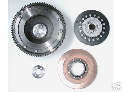

Paul Minnaert Posted October 11, 2004 Author Posted October 11, 2004 For the one who wants a scura clutch, one new for sale on ebay: http://cgi.ebay.nl/ws/eBayISAPI.dll?ViewIt...7927451917&rd=1 Now we have a picture how it should look

Bruce Reader Posted October 16, 2004 Posted October 16, 2004 Hi to all on the forum. This is my first post, ( a lurker for a few years). I'm the guy Pete Roper was talking about from Melbourne Australia with the latest Scura clutch issue. Basically my story is the same as Roberto's with near exact triangular cracks through the fly wheel. Roberto's description of failure was word for word like my expierience. "The first signs of it was vibration through the clutch lever and a little more noise while changing gear. On investigation I've found that the flywheel centre where it is attached the the crank has separated from the rest of the flywheel, and many cracks are radiating outwards." This thankfully all started happening at a moderate speed with no rear lock up etc. The bike was fixed at a local dealer, (light weight Ram clutch installed). As the bike was 3 months out of warranty no one is listening from the importer. I have the clutch at home and it is a Ram. I bought the Scura from another dealer with 5000kms on the clock and it now has 22500kms on it. I will be having a chat with the parts guy at Moto One in Melbourne to compare the the broken with the new to see if there is a difference. The new Ram unit has a different friction surface on it and it must be lighter than the previous Ram unit as it definitely spins to red line much quicker than before. It would be "nice" for Guzzi to take notice and act on this before someone is killed !!! Regards Bruce
Paul Minnaert Posted October 16, 2004 Author Posted October 16, 2004 Hi bruce, can you put some pictures here? I can't figure out why until now only scura's have the problem where the same sort of clutch is also on rosso mandellos and tenni's. There must be something different.
Ballacraine Posted October 16, 2004 Posted October 16, 2004 Hi bruce, can you put some pictures here? I can't figure out why until now only scura's have the problem where the same sort of clutch is also on rosso mandellos and tenni's. There must be something different. 35496[/snapback] Is it just that there are a lot more Scuras than Mandellos & Tennis & that they all will fail given enough time? Nige.
Ballacraine Posted October 16, 2004 Posted October 16, 2004 I have been looking at the photos posted. Is it possible that the radius on the edge of the boss may be too sharp, causing a stress point as the flywheel accelerates & decelerates. A change of design incorporating a larger cross section around the boss would be stronger? Nige.

Bruce Reader Posted October 18, 2004 Posted October 18, 2004 Bruce. I'd be really, really, interested to have a squizz at it if you'd let me. I've got to come down to Melboring at some point erasonably soon as I've got a motor and gearbox to drop off and my beautiful, lovely Convert to pick up. D'you know Phil Doland or John Ferguson? They're both in the Vic club I think. If you could drop it off to one of them or just get Steve Denny to send it up with my next parts order I'll just have a squizz at it and return it to you, I'll pay postage etc. Pete 35537[/snapback] Pete I've dropped off the clutch/flywheel to Steve at Moto one. Your more than welcome to examine and or look into a solution for this. Don't worry about the returning it. Its yours to play with. The more you start to play with these new bikes the sooner you may have one. We all would probably benefit from this. regards Bruce ps. are you able to post some pictures to the forum of the unit ? The damage is remarkably similair to previous images.
Paul Minnaert Posted October 18, 2004 Author Posted October 18, 2004 Bruce, Do you know if the clutch has been worked on before, because one of the things Guzzi says about it, that it it occurs because of wrong mounting torque by dealers or third partys.
pete roper Posted October 18, 2004 Posted October 18, 2004 Bruce, Do you know if the clutch has been worked on before, because one of the things Guzzi says about it, that it it occurs because of wrong mounting torque by dealers or third partys. 35605[/snapback] Really? Do I detect the smell of frogshit in the air ? What sort of washers are used with the mounting bolts? Given that all the alloy wheels I've seen that have gone tits-up have had the alloy marked by schnoore washers I wonder if this is a consideration? Perhaps the bolts or their washers are starting stress raisers in the alloy? The torque argument sounds like a 'We haven't got a clue' answer to me. Oh, Thanks for sending me the clutch Bruce. If I can see anything specific I'll let people know but obviously I'll just be making wild guesses probably so don't take what I say, (If anything.) as gospel. Pete
Baldini Posted October 18, 2004 Posted October 18, 2004 ...What sort of washers are used with the mounting bolts? ... As I remember there's a circular steel plate that all the flywheel bolts go thru to bolt up the flywheel to the crank? KB
guzzi323 Posted October 18, 2004 Posted October 18, 2004 As I remember there's a circular steel plate that all the flywheel bolts go thru to bolt up the flywheel to the crank? KB 35622[/snapback] That's what mine had when I took it apart. johnk
