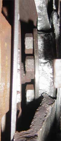

Paul Minnaert Posted October 18, 2004 Author Posted October 18, 2004 that's sure, I have a nice see-through picture here. ALso the thing is pitured on the picture from the new clutch
Bruce Reader Posted October 21, 2004 Posted October 21, 2004 Paul- Don't know if the clutch was worked on before i owned the Scura. It was owned by someone from the previous Australian Guzzi importer. The bike had 4500 kms on it when i bought it. I'll see if i can find out. The Ram unit that is in the bike now went from quiet to noisy after 500 kms. This clutch/flywheel feels lighter than the previous. Steve from Moto One states that the unit now on my bike weighs 1.4 kg whereas the old unit come in at 4kg. Let us hope the extra weight wasn't saved around the bolt holes. I wasn't able to directly compare the two units as Moto One is out of these Ram kits. I'm no engineer but the broken flywheel looks like it could retain more "meat" around the central area. Leafman- My bikes clutch performed perfectly from day one with a similair riding style that you mentioned then it munted itself with very little warning at 22500 kms. I'd enjoy your riding while being wary ! Pete- looking at the bolt holes. Doesnt appear as if anything other than flat surface contact was made around the holes- nil gouges etc. Have a look and see what you think. Regards Bruce

pete roper Posted October 30, 2004 Posted October 30, 2004 Well, Bruce's clutch and flywheel arrived yesterday and I just got a chance to pull 'em out and have a look. To be honest I think the issue is that the alloy basket is simply too bloody thin! Compared to one of the anodised Alloy wheels that are available for the (Less powerful.) earlier models the thickness of the RAM/Guzzi part is a lot less. The last *real* RAM unit I installed was on an 1100 Sport C and from memory the whole unit looked substantially different and I certainly don't remember the back of the wheel being quite so skinny? Do you want me to take some pics so someone can post 'em up here???? Pete

pete roper Posted October 30, 2004 Posted October 30, 2004 I had a bit of a closer look at the whole wretched pile of sh!t while I was working on my own bike today, (Bloody SP, It's only done 89,000Km's and the clutch had started to get touchy. I went in to give it a wash and the next thing I know it's two and a bit hours later and I'm holding the rear main bearing in my hand thinking, "Why did I take that out? The seal nly looked a *little* wet?" ) and while obviously the flywheel is 'Donald Ducked' what caught my eye was the fact that the clutch boss was incredibly worn, as were the friction plate splines. I'll take pics but there is at least 1.5mm of free play betwixt the boss splines and the plate splines and this to me indicates that the idle speed was way too low. Whether the idle speed was set ower than the manufacturers recommendations who knows but I'd certainly suggest that with this light a clutch assembley that you should get it up a bit. With my little hot-rod which a;so has bugger-all flywheel and is in a fairly high state of tune I have the idle, (For a variety of reasons.) at between 1,300 and 1,500. With a motor with high comression ratio and a cam designed for more top end the power pulses at very low RPM are going to be harsh and irregular. The lack of a heavy flywheel to even out the pulses by storing and releasing energy over the whole 720 degree cycle is going to exacerbate these problems so to my mind, get that idle speed up and DON'T sit at the lights with the clutch in, (I've been telling Guzzi owners this for years and still I see buggered clutch bosses and flywheels. The small spline boss in my hot-rod is the same one that it left the factory with in 1979, it's done nearly 300,000miles and while less than perfect it's still serviceable. I'm not a bloody magician but I do set my idle high and don't sit at the lights with the clutch in, so..... ) Just to prove to you that I am *really* perverse I'll tell you that the real reason I took the gearbox off the SP was to fit an Ambo flywheel. You know. The one that weighs about as much as a complete V11 . Why? Because for a fast, point to point tourer a VAST flywheel is GREAT!!!! At the same time it's getting LeMAns mid-valve heads, 88mm barrels and pistons to suit and a cosmetic freshen up to ensure it's devine ugliness is around for another 30 years Pete
