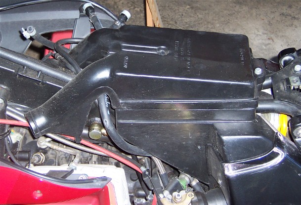

Guest aj howard Posted October 13, 2004 Posted October 13, 2004 Well I finally got around to an airbox mod for the Rosso.. First I scored an airbox lid off E-bay for $3.. Then I took it to work and dremmeld off part of the top, leaving a "bar" to keep the under tank heat insulation from clogging the filter should it come off. Next I got a K&N filter online for $32 which included shipping.. very nice Presto chango... and wow what sweet noise!!! The dealer had set my FI a bit richer. Time will tell if I can wait till I have the $$$ for pipes before I get a PCIII. I would include some photos, but to be honest I forgot how to post them here... AH well..
Guest aj howard Posted October 14, 2004 Posted October 14, 2004 Ok, remembered how to attach files... and here are 3 (all less than 90k each). I used a "rotozip" style cutter, then sanded it down. I was teaching class at the time so my cuts were not 100%. Who cares when it's under the tank anyway. I like the fact I have the origional parts to put back on if I want/need to. I love the sound it makes, it is even harder to keep off the throttle now.. what will happen when I get the pipes and cross over with pcIII?? Love my guzzi...

antonio carroccio Posted October 14, 2004 Posted October 14, 2004 Ok, remembered how to attach files... and here are 3 (all less than 90k each). I used a "rotozip" style cutter, then sanded it down. I was teaching class at the time so my cuts were not 100%. Who cares when it's under the tank anyway. I like the fact I have the origional parts to put back on if I want/need to. I love the sound it makes, it is even harder to keep off the throttle now.. what will happen when I get the pipes and cross over with pcIII?? Love my guzzi... 35344[/snapback] Can you tell us in few words the result of this operation? I mean how did respond the bike by this changing? Ciao
Skeeve Posted October 17, 2004 Posted October 17, 2004 Hi AJ - maybe I'm missing something, but, if you aren't installing a higher flow exhaust -- what is there to be gained by opening up the airbox (other than increased intake noise/music)? Is there a real performance gain to be made with this mod? Ever wonder why intake valves are bigger than exhaust valves? It's because there's so much more power to be gained from getting more mixture into the cylinder than there is in getting the spent gases out [which they kinda want to do anyway, since they're all hot & expanding...] Let's put it another way: what's the quickest way to improve your car's performance when you notice the mileage is getting worse and the get-up 'n' go has got-up-n-went? By changing that plugged air filter for a new one, n'est-ce pas? In the same way, decreasing the intake drag on your Goose, Hog, [insert name of non-race rep crotch rocket here, since those already have the intake restriction all-but engineered away...] is the quickest way to some free ponies. In the real world, there are trade-offs that have to be considered like louder intake roar [which is why the manufacturers stifle the Bikes in the first place, to sneak'em under EPA's noise restrictions...]
Guest aj howard Posted October 17, 2004 Posted October 17, 2004 Well that sort of answers the question, that and I had the airbox lid, and just had to do it. Going by "seat of the pants" it feels faster and revs a little free-er, but so much of s.o.t.p. is in what you feel and think that I know just the howl of the intake makes me think I am going 5 mph faster. I was going to get all scientific and get the bike dyno-ed all stock and then do it after each mod.. but who am I kidding, on a teacher salery... yeah right I would never be able to afford it I do love the bike though, it is a really sweet ride
