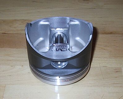

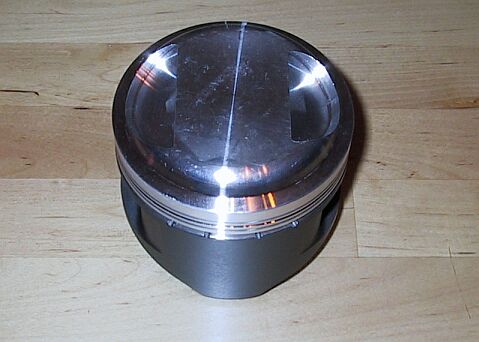

al_roethlisberger Posted November 1, 2004 Posted November 1, 2004 Here are some photos of the Mike Rich "drop in" pistons I received the other day in advance of my engine case swap. I can't offer much technical detail other than they are lightweight, with an "improved squish", and about 10.5:1 true CR in my case(due to some previous work), but normally about 10:1 true. They also have an anti-friction coating on the skirts. If I recall, they were about $330 for the set. For more info, contact Mike Rich, at Mike Rich Motorsports: http://www.cookedgoose.org/sponsors/richmotorsports.htm al

al_roethlisberger Posted November 1, 2004 Author Posted November 1, 2004 OK, here are the photos of the Mike Rich piston:

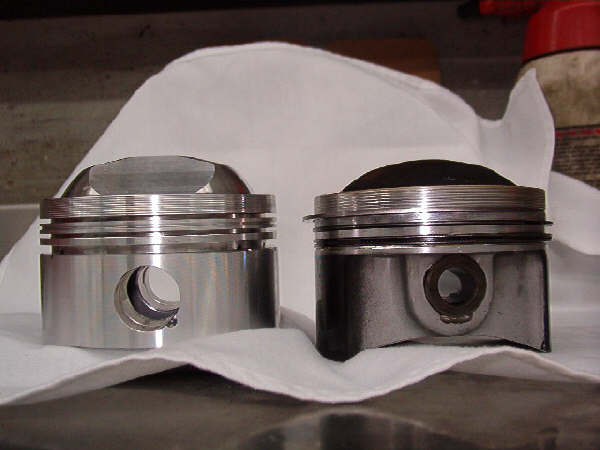

al_roethlisberger Posted November 1, 2004 Author Posted November 1, 2004 And although I don't have a stock piston with which to compare it, here is a shot of the FBF 11:1 piston, with the stock V11 piston on the right:
jrt Posted November 1, 2004 Posted November 1, 2004 Hi Al, Are those Mike Rich pistons coated on the skirts? Thanks for posting the pictures! J And thanks Jaap for changing the file-storage size!
al_roethlisberger Posted November 1, 2004 Author Posted November 1, 2004 Hi Al,Are those Mike Rich pistons coated on the skirts? Thanks for posting the pictures! J And thanks Jaap for changing the file-storage size! 36480[/snapback] Yep, coated with the same anti friction coating used on many of the high-perf pistons from the Big Four. It's extremely durable, and as seems obvious "reduces friction" quite a bit apparently. The pistons have some other advantages in weight, etc... but I forget off-hand. If you give Mike a call, he's always more than happy to give one the full lo-down
Mike Stewart Posted November 2, 2004 Posted November 2, 2004 Al, Are these a drop in design (same diameter and weight of the stock pistons) or does the engine need to be rebalanced? And does Mike have any infomation on any horsepower increases with just the piston change? Thanks, Mike
al_roethlisberger Posted November 2, 2004 Author Posted November 2, 2004 Al, Are these a drop in design (same diameter and weight of the stock pistons) or does the engine need to be rebalanced? And does Mike have any infomation on any horsepower increases with just the piston change? Thanks, Mike 36488[/snapback] These are "drop-in" pistons that require no rebalance. They are a handful of grams lighter than the stock units(although I forget the comparative differences), and can be further lightened(which from what I understand would get into a "rebalance necessary" territory). But as delivered, they do not require a rebalance. ...although like all things though, if one can spring for a rebalance(~$300 from what I hear), it's worth it as the factory often does a "bare minimum" amount of effort in this area from what I understand. Although I didn't end up getting the Carillo rods(just too much $$), I may still spring for the balancing when I have the engine apart. ...I am taking it in Thurs or Fri BTW WRT to HP increase, I dunno. Mike just got his dyno installed a little while ago, so other than feedback from customers, I don't know what sort of figures he can provide off-hand. But I don't expect anything Earth-shattering, just the heavy mid-range boost Mike predicts, and as reported by those that have installed the FBF variety. I hate to keep saying this, but if one gives him a call, Mike can give you the technical answers much better than I can try to recollect from our discussions 6 or more months ago If you'd rather email, his new email is: mrmsport1@aol.com al
helicopterjim R.I.P. Posted November 2, 2004 Posted November 2, 2004 I checked the weight of the FBF pistons and although they look a little heftier than stock they are only about a gram heavier. I can't say that the FBF pistons give more horse power because I do not seem to have any more power than some one without high compression pistons (have tried a few drag races) but there sure is a lot more throttle response and everyone I have ridden with notices that (as well as me). As the pictures show the FBF pistons do not have any anti-friction coating. I wouldn't have a V11 without high compression but I would really like to see a direct comparison of the Mike Rich and FBF pistons. The Mike Rich pistons seem to be a better engineered set and lighter weight but the FBF (actually Wiseco) are a slightly higher compression ratio. Shall we race, Al?
helicopterjim R.I.P. Posted November 2, 2004 Posted November 2, 2004 Oh yes! I forgot to say that it takes about two hours and twenty minutes to install tha FBF pistons. Mike Rich pistons should be the same! I suggest you check out the break-in suggestions to seat the new rings! Break-in Secrets
JuhaV Posted November 2, 2004 Posted November 2, 2004 Hello Al, I also purchased Mike's pistons, mainly because he kindly and promtly answered all my questions in a very convincing manner Something that the FBF people did not for some reason bother to do Mike's pistons (manufactured by Ross pistons) should optimize the squish-band heigth without need to use non-standard cylinder bottom gaskets. The manufacturing quality of these pistons is very high. I myself also like the shape of the piston skirts around the piston pin ends with those recesses minimizing the contact area/friction. The 1st and 2nd piston rings are very narrow further minimizing the friction and mazimizing the sealing. Keep us posted when you get your bike on the road with these pistons. For me, it will take something like 6 months before the weather allows riding again. br, JuhaV
