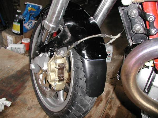

beauchemin Posted November 3, 2004 Share Posted November 3, 2004 I need a front fender extension badly. I was thinking of finding a broken front fender and making my own extension, but nothing has shown up yet. I know that Pyramid Plastics (in the UK) makes front fender extensions for a large number of bikes, but alas not for the V11. Maybe one of their non-Guzzi extensions can be modified to fit - has anyone tried this or know which one might work? thanks Chris B. Link to comment Share on other sites More sharing options...

beauchemin Posted December 15, 2004 Author Share Posted December 15, 2004 I did some internet surfing of fender photographs and decided that the SV650 ('99-'02) had a similar front fender to the V11 Sport. I decided to take a chance, and ordered the Pyramid "fenda extenda" for the pre-2003 SV650 (Pyramid # 05010). The cost was $29.95 USD + $8 express air mail to Canada. The profiles of the two fenders are almost exactly alike - the curves match very well. There are only two minor differences. #1 - The shape of the trailing edge of the V11 Sport fender is more square than the SV650 fender - this does not require any modification (but there will be a difference in shape where the trailing edge of the V11S fender meets the extenda). #2 - The forward side edges of the extenda need to be trimmed to match the shape of the V11 Sport fender. This requires some care to match the shape of the fender's side edge, but is not difficult. Link to comment Share on other sites More sharing options...
Steve G. Posted December 15, 2004 Share Posted December 15, 2004 Hi Chris, That is a very good setup you have there. There is in fact an issue with the factory front fender being more of a cosmetic piece than an integral part of the machine, meaning it is too small to do any good. BTW, I know you've just gotten the bike, and it's a bit cool out there, but those are mighty big chicken strips on that front tire! Ciao, Steve G. Link to comment Share on other sites More sharing options...
beauchemin Posted December 15, 2004 Author Share Posted December 15, 2004 Geez, I thought some smartass would point that out. What you see is the result from my most recent ride in wet & dirty road conditions - those chicken strips you see are just dry dirt. The real chicken strips are much skinnier. Honest. BTW, I know you've just gotten the bike, and it's a bit cool out there, but those are mighty big chicken strips on that front tire! Ciao, Steve G. 38965[/snapback] OK, I take my reputation in my hands by responding to this criticism since protesting too much is usually the sign of guilt. But alas, I can't help myself (foot in mouth disease). Link to comment Share on other sites More sharing options...
