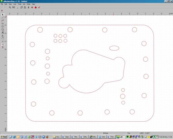

F344 Posted November 8, 2004 Posted November 8, 2004 This looks like the perfect type of project for these guys. http://www.emachineshop.com/ I did a rough sketch with their software (See photo) and it came out to about $700.00 for 10 of them, or $1000.00 for 20 of them. That is in .157 steel FYI Frank

Enzo Posted November 9, 2004 Author Posted November 9, 2004 FRANK!!! What a kick ass idea! Wow, great web site! I didn't know this stuff could be done on line. Here's what I'm gonna do - order one with the correct inputs and dimensions. It will be pretty fun. Then we will lay it on Greg's V11 at home to see if it fits. And, if I can do THAT, I can take on other projects. Vedy vedy interestink.
