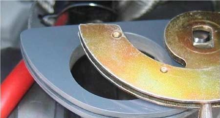

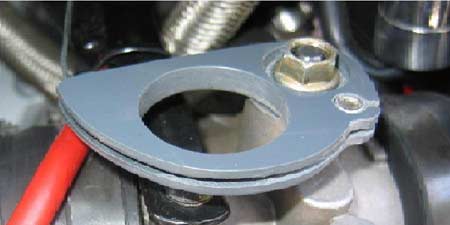

Guest ratchethack Posted November 22, 2004 Posted November 22, 2004 (edited) Ratchethack,I`m very interested in how you made another cable end cam. I have herd/thought about doing this, any chance of a photo-sketch-tech drawing? I`m sure there might be others who could benifit as well. Well done! Cheers, Ross. 37637[/snapback] Ross and Al, the first shot below is the throttle cable cam I made out of 1/4" plastic. It took a fair amount of trial and error, and I tried & tested a few cam contours. This is the one I like best. It increases the OEM cam radius from throttle-shaft center to cable at idle by 18 mm, while keeping the radius at WOT (wide open throttle) the same as OEM. The second shot is the OEM throttle cam on top of the custom one with the shaft holes lined up to illustrate the differences. Try it, I bet you like it Jaap, thanks again for your help!! Edited November 23, 2004 by ratchethack

al_roethlisberger Posted November 22, 2004 Posted November 22, 2004 I am very interested in this modified cam as well. I would appreciate a slightly milder throttle transition as well. ...although I also thought that someone had sourced a milder grip cam from the vendor(Domino??). al
Admin Jaap Posted November 22, 2004 Posted November 22, 2004 I already did, Jaap - per instructions yesterday and the day before. No response 37708[/snapback] It didn't arrive... maybe my spam filter... could you try jaap at veldhorst.nl, please?
Guest ratchethack Posted November 23, 2004 Posted November 23, 2004 I am very interested in this modified cam as well. I would appreciate a slightly milder throttle transition as well. ...although I also thought that someone had sourced a milder grip cam from the vendor(Domino??). al 37710[/snapback] Al, see photos inserted in previous post courtesy of Jaap (thanks again, Jaap!) If I remember correctly, there's a larger radius plastic throttle-end cam available somewhere that fits, but it has a constant radius that doesn't allow WOT because there isn't enough cable travel available at the grip end. The progressive profile I used works great.
