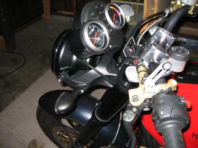

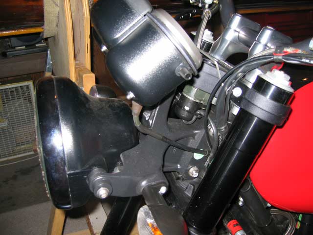

Anyway, Ken, you asked for pics of the frame mounting on my bike....
