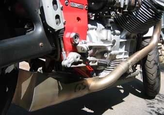

dlaing Posted May 27, 2003 Author Posted May 27, 2003 Got the air filter in today. A little more kick of accelleration. A little pinging at about 4000-5500 rpm. Still running Zero map. I suspect the HP peak will be over 8000RPM. Here is a shot showing how the color is starting to match. You can still tell the Quat-D is a sand blasted finish while the pipes are brushed. It would be a good idea to make a rear fender extender to keep the crud off the muffler.
Martenni Posted May 27, 2003 Posted May 27, 2003 Hi David glad to hear that you are still pleased with the muffler thx for keeping us updated,do u think the fbf air filter would work ok with standard ecu and no pc. Regards Martin ................. Tenni 165 old 950
dlaing Posted May 28, 2003 Author Posted May 28, 2003 Hi Davidglad to hear that you are still pleased with the muffler thx for keeping us updated,do u think the fbf air filter would work ok with standard ecu and no pc. Regards Martin ................. Because it started pinging after putting in the FBF open lid kit, I would have to say that re-mapping be it with ultimap or PCIII, is a necessity. If you only got the BMC filter and did not open the airbox, there would probably not be a problem. According to Todd at Guzzitech, the K&N in the stock airbox and the stock filter require the same map. From what I understand, if you cut holes in the airbox lid or get the FBF kit, the bike runs leaner. My bike is still rideable, but I have to be conservative with the throttle in the mid range rpms. Next weekend, I will enrich the mid range, by buttons or map.
