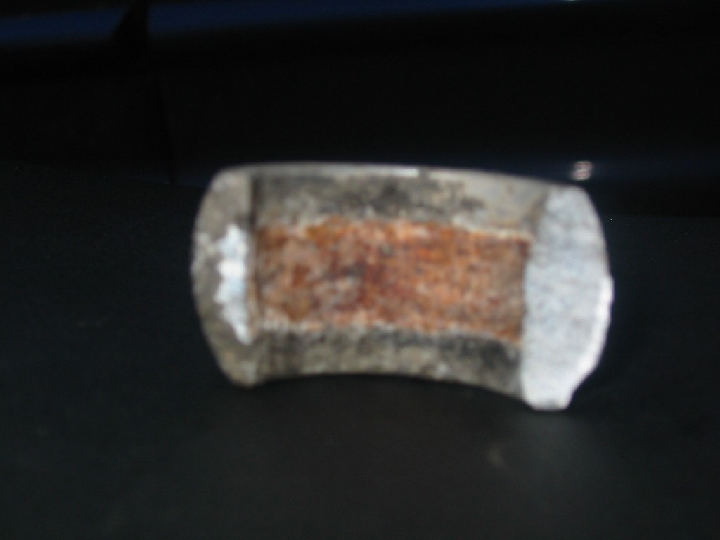

Martin Barrett Posted January 7, 2005 Posted January 7, 2005 The oil light failed to go out this morning. So I first went to check the level so put her on the shop stand. Was OK but dribbled a little more in for good measure. The light still wouldn’t go out. But was very feint at tick over. Now I suspected that it would probably be an electrical short around the switch. Only last week the side stand switch was playing up but was fine the next day, before it was WD40’d. So I hoped a squirt of WD40 would sort it out and it would be fine when I went back to it later. So a quick squirt on what I thought appears to be oil pressure switch. Then put her away and search on the board to check. Roll her off the stand. There’s a metallic tinkle and this half a donut shaped piece rolls out from under the bike. Initial thoughts are what have I knocked off with the stand? Picked it up thinking exhaust collar? As soon as it’s in my hand I suspect the rear shock mounting eye. Quick look reveals my fears to be right. Looking at the piece two thinks struck me 1- Rust around the inner face. I assume it was assembled dry without grease. 2- One fracture was clean and shinny the other had a dirty arch around a very small clean area. I came in and reached for the service book, checking to see if this was covered by PDI or a service item. I would have hoped greasing the suspension linkages would have been at least an annual service item. Called the dealer and then the recovery centre. The only upside of this storey was within an hour she was on the back of trailer being taken to the dealers, all covered by its warranty as only 18months old with less than 8,000 miles. I’m so glad that it failed under these circumstances not at speed on the road. Debs now has it in for the Guzzi big time. Given the number of little issues it has had and now this. but it's because she cares The moral of the story is when Pete and others say when you get your new Guzzi take it apart and reassemble it with grease they mean it.

jrt Posted January 7, 2005 Posted January 7, 2005 As above, Martin- Glad you are OK. It looks like the metal on the shock mount has been oxidized for awhile (the darker semicircle). One probable explanation of this is that the shock mount has been cracked for quite a while. The rust buildup expanded and eventually broke it clean in two. Grease would have prevented rusting, but the eye would still have been weak. I would suggest that the root of the problem was in the manufacture of the shock. This is the lower mounting eye? Jason (goes to look at his bike)
Guest ratchethack Posted January 7, 2005 Posted January 7, 2005 Martin, great good fortune has certainly smiled upon you. Congratulations on discovering this while taking the bike off the shop stand rather than on the road! Just speculation, but from your pics and description, I'd expect that during assembly, some witless wrench maven likely dropped the shock on a hard surface, resulting in a hairline crack in the shock eye, not immediately damaging it enough to cause a complete and obvious fracture. Riding the bike would of course complete the fracture at some point - a great example of a mechanical time-bomb. If this is what actually happened, I'd expect it to be a very rare thing. BTW - my shock eyes also came dry from the factory, along with the shift lever pivot and the internal cush drive sleeve. This last had developed a horrendous amount of "red-brown grinding paste" which had liberally distributed itself around inside the drive housing, and had undoubtedly opened up the clearance in the sleeve Glad you're OK!

pete roper Posted January 7, 2005 Posted January 7, 2005 I'd suggest either a casting fault in the eye or damage caused by, as somebody else said, abuse, ie Guiseppe using the shock eye to get the top off his early morning bottle of Nastro Azzuro in the assembley line. One of those rare and unfortunate things I'd guess I wouldn't think it is an endemic fault. Interesting about the lack of lube on the shock mounts, I'll add that to my list of stuff for PD that I'm compiling. Pete

exwtk Posted January 9, 2005 Posted January 9, 2005 Hello Martin, Did you attend the V11 meeting in Varseveld Holland? I was there, Due to bad handling of my bike during that meeting I started wiggling around at the back and discoverd play in the rear. After further checks I found out the top eye of my REAR shock Sachs-Boge had a crack in it!! Same as you, wasn't driving, but likewise quite upset. Since then the shock is replaced by a HAGON shock (Britisch manf.) Greetings and don't loose your faith in Guzzi. Co.
Martin Barrett Posted January 9, 2005 Author Posted January 9, 2005 Did you attend the V11 meeting in Varseveld Holland? Yes. I think we were talking at breakfast. I remember the mention of time away at sea. Jumping to conclusions from your avtar. Is this you, closest, with back turned to camera talking to the chap who had the modified scura on the Saturday ride outduring the return leg from TLM to Vasseveld and don't loose your faith in Guzzi. No not yet , Looking forward to having her back soon, PLEASE . want to go to the UK V11 and Buel Highland Fling and the GMG. Not quite the same turning up in a Ford Mondeo. rare and unfortunate things I'd guess I wouldn't think it is an endemic fault. I found out the top eye of my REAR shock Sachs-Boge had a crack in it!! Thats two - How many single plate clutches disintergrated? One swallow doesn't make a Spring - Two cracked Suspension eyes doesn't make an endemic problem. It helps that it sits there quietly and doesn't rattle like a can of nails shouting "Am I going to fail or is this normal"
