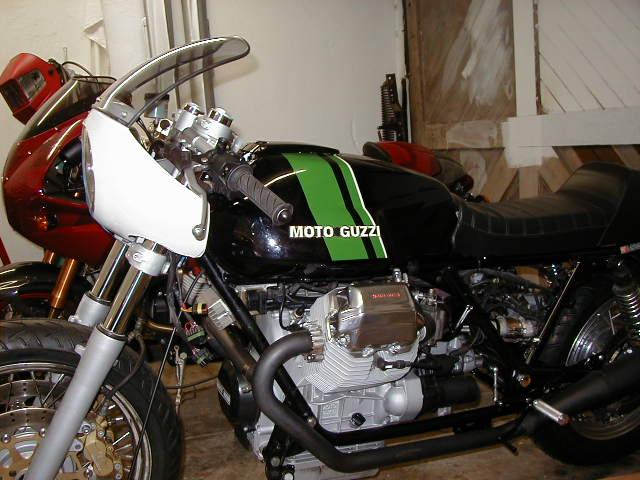

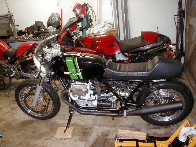

Mike Stewart Posted February 2, 2005 Posted February 2, 2005 Tim, This is what the Jackal looks like now And now you guys know what I have been doing with my spare time. Mike Hey Mike.. where ya been? last I heard you'd driven cross country for a jackel that you were going to turbo charge or something??? Anyway, thanks very much for the kind offer. I'll PM you offline.. Edge, I know what you mean about quality time... That's why I keep my goose clean, more for the inspection than the appearance. Cheers, 42168[/snapback]
GuzzTim Posted February 2, 2005 Author Posted February 2, 2005 Diabolical !!!!!! so when's the first road test? looking great Mike, but where's the NOx ? Cheers, Tim
Mike Stewart Posted February 2, 2005 Posted February 2, 2005 It will be about another month till she gets on the road. I still have alot of little things to figure out. What I have learned about the Tonti framed bikes is that no matter what year you may have, many parts are interchangeable. This 2000 Jackal now has a 1991 fuel tank from a 1000S, a Bub exhaust system from a 1978 Lemans 1, Agonstini Lemans 1 rearsets, Lemans 1 lower frame rails, V7 side stand. The only problem area is the rear brake master cylinder which has an adaptor plate to mount the larger newer master cylinder. I will have to relocate the mastercylinder or go to an early style master cylinder and hope the bore size will work with the later rear brake caliper. Oh yeah, I need to make a battery box to relocate it under the bike for a lower center of gravity. Mike Diabolical !!!!!! so when's the first road test? looking great Mike, but where's the NOx ? Cheers, Tim 42382[/snapback]
