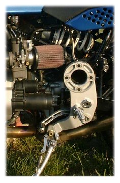

zebulon Posted February 3, 2005 Share Posted February 3, 2005 using paul new feature i discover this who post this ? it seems to be a ducati stand, that's it ? Link to comment Share on other sites More sharing options...

zebulon Posted February 3, 2005 Author Share Posted February 3, 2005 i know the Daes stand but it is wafully too much for what it is :!: nearly 400 EUR for a sidestand system is just crazy ! This is why i ask about this picture because it really seems to be a duc system and i could have such parts for few But just want to be sure i have so many thing to do on my bikes that i don't want to lose too many times for such things About the interest : on a dayto or a sporti if you are not more than 1.85 m you will have some trouble to put the side stand when you are on the bike. Link to comment Share on other sites More sharing options...

Paul Minnaert Posted February 3, 2005 Share Posted February 3, 2005 Jean Marc, I did a serch and found the topic for you: http://www.v11lemans.com/forums/index.php?showtopic=4036 The stand is a bit modified sport 1100 stand as I can see. Looks a bit bend to compensate for the more lenght. In a picture that has a name like http://www.v11lemans.com/forums/uploads/po...91915_thumb.jpg The 1087 is the usernumber who posted it. And when you then do: http://www.v11lemans.com/forums/index.php?showuser=1087, you know who it posted. Then go to the "Find member's posts", and find the post Link to comment Share on other sites More sharing options...
