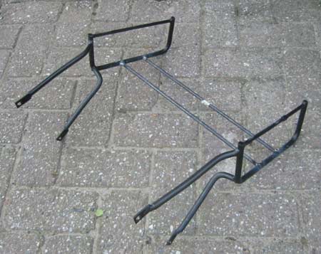

jrt Posted February 18, 2005 Posted February 18, 2005 The stays on the rear fender are just to keep the frames held apart. You could probably just run a rod all the way across to accomplish the same thing, although you might have to cut the existing stays. it would go from |--o o--| to |-------| (not to scale) don't you just love ascii art.... Jason
Admin Jaap Posted February 18, 2005 Posted February 18, 2005 I did exactly what JRT suggested: Two struts welded between the two frame halves. Works fine. Here's a few pics: BTW, the frame is for sale if anyone is interested.

DeBenGuzzi Posted February 19, 2005 Posted February 19, 2005 I bet you could get away with one bar welded on. 2 seems like overkill. I don't want to break down and get turn my sport into a sport touring. thats why I'm going to get an Aprila futura.
Admin Jaap Posted February 19, 2005 Posted February 19, 2005 I decided two use two bars. It takes out the sideways movement, completely and that helps to keep the welds intact.

Martin Barrett Posted February 19, 2005 Posted February 19, 2005 (edited) I decided two use two bars. It takes out the sideways movement, completely and that helps to keep the welds intact. Don't blame you, my standard mount broke one of its welds. The reweld only lasted a couple of days, so was replaced with an L shaped braceing piece, ugly but effective. Sorry no pic - going out to rectify Oops need a touch of rust proofing. Edited February 19, 2005 by Martin Barrett
