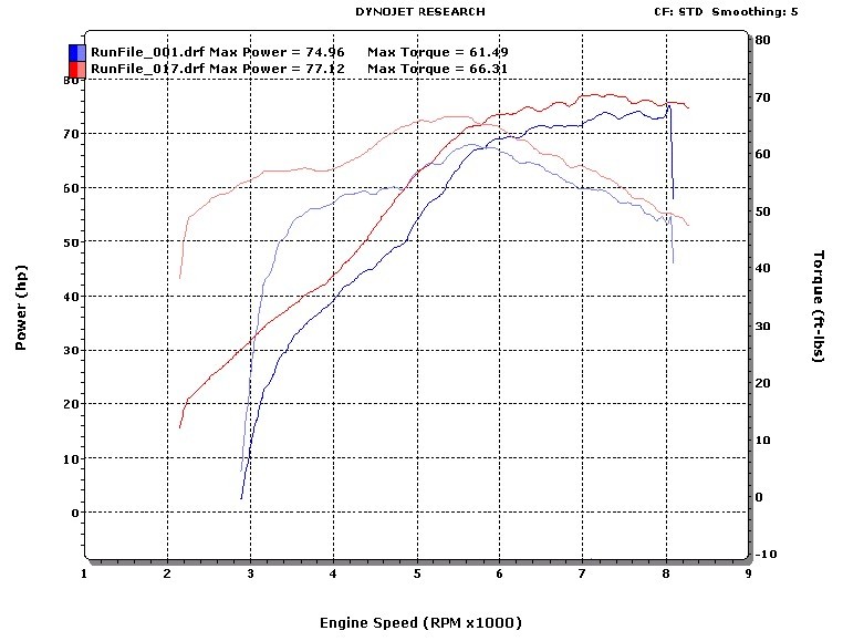

Guest Michael Derby Posted February 25, 2005 Share Posted February 25, 2005 For every motorcycle enthusiast I am sure there exists the perfect machine. The right blend of absoulutely everything they are looking for in a bike, that allows them to hit some type of Zen Nirvana everytime they ride it. For me I have found it - My 2004 Nero Corsa. I just completed the changes. I have had the OHLINS completely reworked with new springs front and rear, and then professionally set up by a Ducati racing machanic. I put on MG Titanium's, Stucchi x-over, FBF Airbox eliminator with K&N filters, Power Commander, and topped it all off by having the engine custom dyno'd for optimal fuel mixture with the PC III. Attached is one of the DYNO reads. I didn't get the top end out of it that others have made, but the power delivery is awesome. Their DYNO is set to exact read to perhaps just a little low, as the set up DUC's for racing and they told me they can't afford to have their DYNO set to read high, cause then the bikes get checked and they can't race. I want to put a huge plug in for the DUC SHOP here in Atlanta. www.ducshop.com Mark Sutton is the main mechanic and he used to be lead mechanic for a US Ducati racing team. While they primarily work on Duc's, they seemed to enjoy working on the Guzzi and helping to set her up just right. If you are in the Atlanta area and want to jazz up your bike, this is the place. They are just plain great to work with. Mark is the Zen Master at setting up suspension, I can't believe the difference the ride is when the suspension is truly set to optimal performance. They can also set up maps for the PC and send them out to folks as well. Curious, Mark at DUC Shop thought it probably may not be worth the money to add high compression pistons, new valves, etc., etc., that it would be alot of money to chase just a few top end HP's that probably would not kick in till the upper end of the rev range. Thoughts from anyone who has done the inhale, exhale, and drinking mods, and then did some of the internal work? Are the changes significant? For now I am just going to enjoy her they way she is - Link to comment Share on other sites More sharing options...

GuzziHutch Posted February 25, 2005 Share Posted February 25, 2005 Michael, Your torque gains are absolutely awesome, especially the gains below peak torque, which is exactly where you would like to have torque curve improvement for a more ridable, responsive highway machine. Thanks for the info on DUC SHOP. I live in the Charlotte area and would like to have a custom PC III map done for my Lemans but I don't feel comfortable taking a Guzzi to any of the dyno shops around here. Maybe DUC SHOP is the answer. Joe Link to comment Share on other sites More sharing options...
