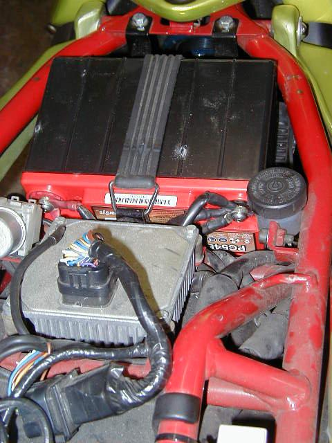

Mike Stewart Posted March 14, 2005 Posted March 14, 2005 Well, it turned out to be a nice day afterall, things are warming up in California . I was working on the 1100S and decided to get the Rosso ready to ride tomorrow. Turned on the key and she cranked over slowly. OK, no problem, I will put a slow charge on the Battery. I pull up the seat and I notice that the ECU wiring connector is being pushed down by the seat (no, not my ass). Humm, I pull off the seat from my 2000 V11 Sport and find that the computer is turned 180 degrees the other direction. So, the seats are different between the different years but there is more clearence when the connector of the ECU is pointed toward the rear of the bike. You might want to check your bike to see where your ECU connector is pointing . Mike

Guest ratchethack Posted March 14, 2005 Posted March 14, 2005 Mine was like Mike's too (Y2K). It appeared that the wires out of the back of the connector had been repeatedly mashed against the bottom of the seat when the seat flexed going over hard bumps. I decided this wasn't a long-term healthy situation for the connector and re-mounted the ECU with the connector facing downwards - now there's adequate clearance & no more mashing of the connector.

callison Posted March 21, 2005 Posted March 21, 2005 Mine had the wires up and they are (were) quite mushed together (no insulation displacement). Separated all of the wires, flipped the ECU over and I still have a problem with the ECU fuse blowing. Not likely the connector though. I don't see any real need to change the orientation of the ECU unless you're uncomfortable with how it sits in your bike at present.
Mike Stewart Posted March 29, 2005 Author Posted March 29, 2005 Soooo, After alot of thinking , I decided to mount the ECU like my 00 V11 Sport. Reason being is if the PCIII goes out, all I have to do to get back on the road is unplug the PCIII and plug in the factory ECU connector . Presto, back on the road again . I do not carry a 7mm socket wrench in my tool bag , so I figure just plug and play and down the road if there is any PCIII issues . Mike
