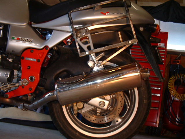

Lex Posted April 10, 2005 Author Posted April 10, 2005 As for the Givi mounts, I need to explain my "design brief" before I post the picture. 1. I ride the Guzzi solo and I didn't want the bags hanging off the back of the bike screwing up the handling. 2. In a related area, I wanted the bag as close to the center of the bike as possible. 3. I am a fair designer but not the best fabricator in town so I needed to hold the principal of KISS (Keep It Simple, Stupid) in the front of my thoughts while I was laying things out. No point in designing something I couldn't build. 3. My friend and all around nice guy TaminatorV loaned me his bags and the mounts off his VFR in exchange for making a second set for him so the design had to be repeatable. That said, here is first left side mount:

tomsp Posted April 10, 2005 Posted April 10, 2005 Lex -- those givi's look pretty good (course so do the tekno"s!) I like the small size and position of the givi's

jrt Posted April 10, 2005 Posted April 10, 2005 Looks good- I think that if you are going to ride mostly solo, then it's a great setup. I like the fact that the center of mass is ahead of rear axle. Good thinking there. As a generality, it's a bad idea to put heavy stuff behind the bike or aft of the axle. On my Eldorado- which I merciliously load up for camping- the handling gets squirrelly if I put too much in the bags. Lex, When you remove the bags, can you carry a passenger? Ben- the '01s have red frames at least in some cases. Like on mine. Jason

Lex Posted April 10, 2005 Author Posted April 10, 2005 Looks good- I think that if you are going to ride mostly solo, then it's a great setup. I like the fact that the center of mass is ahead of rear axle. Good thinking there. As a generality, it's a bad idea to put heavy stuff behind the bike or aft of the axle. On my Eldorado- which I merciliously load up for camping- the handling gets squirrelly if I put too much in the bags. Lex, When you remove the bags, can you carry a passenger? Ben- the '01s have red frames at least in some cases. Like on mine. Jason 48276[/snapback] Jason, Thanks for the kind words. I've been riding bikes with hard bags since the early eighties, I have experienced first hand what happens when too much weight is placed too far to the rear of a bike and it scared the sh*t out of me. I got used to bad handling in the Seventies (Kawasaki triples did amazing things totally stock and unloaded ) but having a fine handling bike turn into a beast after it was loaded incorrectly really opens your eyes. Even with a light load the very rearward position of most bags affects handling, just not as much. The right place to put the weight is just forward of your knees, that areas is full of cylinder head of the Guzzis. The mounts lock the passenger pegs in the "up" position. Rather than come up with a complex solution I just made the mounts easy to remove. Three bolts (two on the top mount and the muffler mount bolt) and all of the mounts but the small plate attached to the top of the peg/ muffler carriers are off. I never carry a passenger on the Goose, I have a K1200LT for that sort of thing. If a reason comes up I can have the mounts off in 2-3 minutes. I think the mounts will look pretty good once they are cleaned up and painted. They look rough now because they are rough, still subject to coming off and being changed is I come up with a better idea. I dream goal is to replicate the mounts in aluminum. That would look great with the silver bike and be a bit lighter. I need to improve my AC welding before I try that one. Carl: Regarding Ms. Stewart's shoe obsession... Good point, I guess I should qualify my statements. Plenty of room for non-obsessive people? Lex
