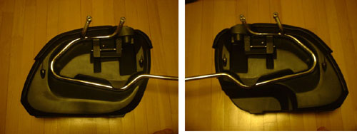

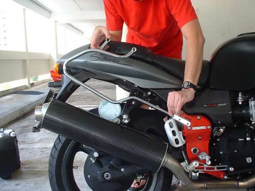

Guest Darth Maul Posted January 27, 2003 Posted January 27, 2003 After looking around for a suitable panniers for the V11, I have decided the BMW 1200C side panniers is the way to go...!!! Aesthetic is my first priority. The side panniers is made of hard plastic n wrap in leathers. Its available in Black, Brown and Dark Blue.(???) I have choosen the Black Leathers to go with my Matt Scura. This is the initial stage. I will post more information as i made the modification to the V11. I have fit the same panniers to my previous Ducati Monster 900. So I know it can be done. I have to sacrifice the pillion footpeg for the Monster 900. This time round... I will try to accomodate the pillion footrest in. Modification needed: •Welding will be require to the subframe to hold the Panniers' bracket. •removal of the rear signal light. (to replace with a aftermarket light) •to make a new footrest frame for the rear pillion. So that the panniers would not stick out too much from the rear. And the pillion would have a more forward leg position. about 10cm forward. below are picture of the bracket position... and how the bike will looks like with d panniers. As you can see i can't take sharp pictures.

jrt Posted January 27, 2003 Posted January 27, 2003 I hope your passenger has a short foot! Seriously- that will look real nice. Are the BMW panniers symmetric or asymmetric? I recall riding on an R1100 and the bags were very different sizes. Cheers, Jason

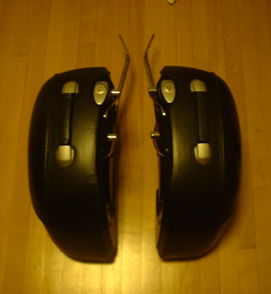

Guest Darth Maul Posted January 27, 2003 Posted January 27, 2003 these are the image of the panniers from behind. Its quite symetrical except for the right box where the bottom part is cut in a little to fit the BMW cruiser exhaust. ( i think...???)

Guest Darth Maul Posted January 27, 2003 Posted January 27, 2003 these r the view from the top. the panniers wont fit a full face helmet nor a half cup helmet. but its enough for a raincoat, grocceries, laptop n etc. the pillion footpeg is quite a tricky one. it might touch my heel. Will have to be carefull there.
joe camarda Posted January 27, 2003 Posted January 27, 2003 Very nice!!! Can you show some detailed photos of the welds and mods necessary? Ive half a mind to attempt myself!

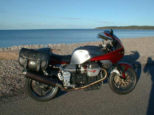

alfaguzzi Posted January 27, 2003 Posted January 27, 2003 Yes, leather bags looks nice on our bikes. What do you Le Mans riders like this set-up? Hepco Becker 2x28 liters
Lex Posted January 28, 2003 Posted January 28, 2003 I'll be honest and admit my first responce was YOU DID WHAT!? but after looking at the pictures I'd have to say this is the best looking hard bag set-up I've seen on V11 Sport/ Le Mans. The rounded shape of the bags fit the bike really well. Nice work, Lex PS On most BMWs the cut out on the bottom of the right bag is for the final drive.
Guest J.R. Posted January 29, 2003 Posted January 29, 2003 I too am looking for a hard bag set up for my Lemans. I remember some time ago seeing pictures of the rack system from Hepco-Becker,but saw no bags attached. I believe it was Ian from Wash. state. Does any one have pictures of the H-B set up? My only critizism of the H-B rack was that it didn't blend in to the lines of the bike when the bags were removed. I've toyed with the idea of BMW system bags and Givi bags, but haven't had time or money to persue the ideas. Any one out there fabricating or have the same ideas? J.R.
Guest Jaap Posted January 29, 2003 Posted January 29, 2003 IMHO I think that leather bag setup is more suited for HD's or JapHD's. I think the issue is that a lot of you think the LM is a tourbike and a lot think it's an old fashioned sportbike. So different accessories are mounted accordingly. The higher handlebars and lower footpegs fit in the same category. Personally, I never would mount them. I'd buy a Cali! But hey... whatever makes you happy. This is a tolerant forum. And different opinions make the forum more attractive! Just my $0,02 Jaap
Guest Brent Posted January 29, 2003 Posted January 29, 2003 (Sorry, Jaap, I couldn't resist. ) But I am with Jaap on the use of leather bags on the LeMans.
Guest dkgross Posted January 30, 2003 Posted January 30, 2003 I like the look of the 1200 C bags on the LeMans. I think I'm in partial agreement that leather isn't really the right look tho. I'm weird. I actually LIKE the Corbin Beetle Bags. I think that sort of setup would kick butt on the LeMans. I'd be more than willing to sacrifice my passenger footpegs for them. Guess it's just a matter of $$$. Maybe I can find a boat builder/fiberglass person around here to try an experiment. The Hepco mounting hardware would be a good start...
