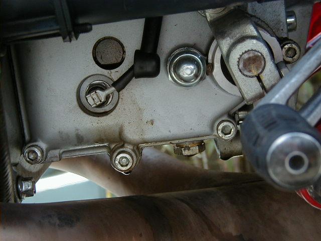

Mike Stewart Posted May 17, 2005 Posted May 17, 2005 Ok Joe and Carl, Now that I can post pictures (thanks again Ben), is it this shaft in the side cover (the one that the oil is leaking out of) that fell out? Mike
joe camarda Posted May 17, 2005 Author Posted May 17, 2005 Mike...going by memory here (?), but yes I believe it is...Carl, what say you?
callison Posted May 17, 2005 Posted May 17, 2005 Ok Joe and Carl, Now that I can post pictures (thanks again Ben), is it this shaft in the side cover (the one that the oil is leaking out of) that fell out? Mike 51958[/snapback] That's the one. If it leaks, it isn't tight. I wonder just how it's secured.
joe camarda Posted May 19, 2005 Author Posted May 19, 2005 So Mike...whats the story on that piece. It looks like that IS the piece that fell into my trannie. How likely is it to cause extensive damage to the trannie? BTW. I saw your parts all over ebay...if I knew what will become of my Sport I would have bought some of them. Joe
Mike Stewart Posted May 19, 2005 Posted May 19, 2005 So Mike...whats the story on that piece. It looks like that IS the piece that fell into my trannie. How likely is it to cause extensive damage to the trannie? BTW. I saw your parts all over ebay...if I knew what will become of my Sport I would have bought some of them. Joe 52166[/snapback] Joe, My bike is in the shop at the moment (Monroe Motors) having the trans recalled preformed. I did tell the service writer to look at the sidecover while the trans is down for the leak. I have an extended service contract but as you know, the side cover is hard to get from Guzzi . I don't know what type of damage the gear would cause that is behind the cover. I would suspect that the pin fell out to the outside and then the gear fell down inside the transmission. If you need a spare transmission, I may have one up for grabs. Mike
