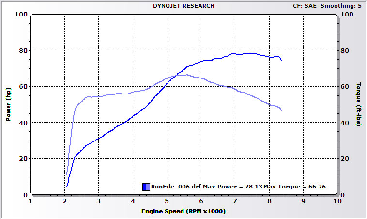

RacerX Posted May 21, 2005 Share Posted May 21, 2005 I got mine done this morning and it maxed out at 78.13 with a max torque of 66.26 crossing pretty much right on 5200. I'm extremely happy with it. Phil The power of the internet. Phil, your dyno is posted above. John at Dyno-Solutions in Danbury, CT sent it to me. DeBen, the PCIII is *NOT* about power, it is about making your motor run as smooth (and best) as possible, without risk of extremely lean or rich spots. Every motor is different. The PCIII is best measured at partial throttle settings like the improvements shown here on this 4v Duc Monster at 20% throttle; - low throttle openings are where everyone lives 90% of the time. How often do you really ride at 100% throttle... so those dyno-charts really are useless outside of comparing data for improvements at wide-open throttle. Todd Link to comment Share on other sites More sharing options...

Guest philbo Posted May 21, 2005 Share Posted May 21, 2005 The power of the internet. Phil, your dyno is posted above. John at Dyno-Solutions in Danbury, CT sent it to me. DeBen, the PCIII is *NOT* about power, it is about making your motor run as smooth (and best) as possible, without risk of extremely lean or rich spots. Every motor is different. The PCIII is best measured at partial throttle settings like the improvements shown here on this 4v Duc Monster at 20% throttle; - low throttle openings are where everyone lives 90% of the time. How often do you really ride at 100% throttle... so those dyno-charts really are useless outside of comparing data for improvements at wide-open throttle. Todd 52359[/snapback] Thanks Todd - much appreciated. I've put around 125 miles on it this afterenoon and I'm very happy to say the least. John offered to do the 'per cylinder' tuning for me but after talking it through I didn't see much benefit in doing it. I know John is having an open house tomorrow so if you live in the area (Danbury CT) and you feel like stopping by, for a minimal sum he'll do a couple of runs for you so you can see how your bike looks. Thanks again John - nice guy - great job. Cheers Phil Link to comment Share on other sites More sharing options...

RacerX Posted May 26, 2005 Share Posted May 26, 2005 John offered to do the 'per cylinder' tuning for me but after talking it through I didn't see much benefit in doing it. Phil, too bad... one of the biggest benefits of the PCIIIusb, and well worth the time and money to do. Think of it as the ultimate "electronic fuel corrected throttle body balancing". Blue is PC111 using map downloaded off Guzzi tech for eqivalent mods. Red is with PC111 dialled in on dyno.Work arranged Moto Corsa on Crescent Suzuki Dyno. As a comparison, they reckon standard V11's have shown a little less than 70HP. Very, very nice job. This shows the benefits of mapping for each bike -vs- a downloaded map. Can you get those dynorun files (Runfile_001.drf & _006) from them for me? I'd also love to have your map for my library as well. Thanks in advance. For fun, those of you who plan to do this in the future... have the dyno tech upload a '0' zero map for you, for a base-line pull. Worth mentioning too... these graphs are only at 100% throttle; how often does one ride there? The PCIII corrects the entire fuel map similarly, so you'll gain similar/large benefits (like what you witness in the graph) at low/partial throttle openings where you ride the most. This is the main focus of the PCIII. 100% throttle pulls are fun to look at, but worthless otherwise. Think of it as a "Tuning Commander", not 'Power'. Link to comment Share on other sites More sharing options...
dlaing Posted May 26, 2005 Share Posted May 26, 2005 DeBen, the PCIII is *NOT* about power, it is about making your motor run as smooth (and best) as possible, without risk of extremely lean or rich spots. Every motor is different. 100% throttle pulls are fun to look at, but worthless otherwise. Think of it as a "Tuning Commander", not 'Power'. I still like the POWER part about it The dyno charts are proof that the PCIII *IS* about Power! But I agree that it is MORE about TUNING, Proper Mixture, and Power EVERYwhere! Maybe you are not allowed to make claims like it will give more power or make your bike last longer, but the dyno proved to me that I got more power, and was no longer producing conditions where the bike was dangerously lean AND rich. 100% throttle pulls tell me my top speed is going to higher, so it is not completely worthless. Most importantly, a bike after the tuning link feels like it is much more properly tuned compared to a properly tuned stock fuel setup. It makes the bike feel like it SHOULD. I think that is what you mean when you say it is not about power even if power is part of the benefit. Link to comment Share on other sites More sharing options...
