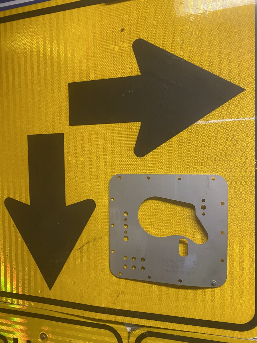

jtucker Posted August 25, 2020 Posted August 25, 2020 The sidestand I have does auto-retract... but I generally defeat that by putting it down by hand and allowing the spring to bypass the bit its normally supposed to catch on. I've gotten pretty good at double (and triple) checking before I set off. But, I certainly understand the concern. There have been times in the past where I forgot... briefly... until getting an uncomfortable, but harmless reminder, which is why I'm quite paranoid about it now. As for the oil cooler, I was happy to see it go. No issues so far, including being stuck in stop-n-go traffic on a hot day. And my engine is... shall we say, "hotter than stock". But yes, that was the message I definitely wanted to convey. They are not "plug-n-play", and there are trade-offs. One very big benefit, however, is that you would need to run the oil extremely low before you start risking cavitation. I know things such as the Roper plate help address that as well, though. The oil sight glass window is a nice-to-have feature as well __Jason
