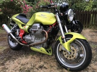

DucatiGuzziIndian Posted October 31, 2024 Posted October 31, 2024 (edited) Couple photos of the completed LED turn signals, Mistral pipes, Rizoma mirrors, new levers and a good old polishing. Edited October 31, 2024 by DucatiGuzziIndian 8
Lucky Phil Posted October 31, 2024 Posted October 31, 2024 24 minutes ago, DucatiGuzziIndian said: And another couple Looks brand new. good choice in mirrors. Phil 1 2
docc Posted October 31, 2024 Posted October 31, 2024 Absolutely gorgeous V11 Sport! Does the regulator hang at a funny angle? Not loose on one side? 1
DucatiGuzziIndian Posted October 31, 2024 Posted October 31, 2024 Yeah thats temporary just to get it into the airflow. Winter project to screw around with it to adjust its position so it is at least somewhat straight. Will also try to shorten the turn signal stalks a little, with some type of custom spacer thats a little shorter than the stock spacers currently in place. 1
docc Posted October 31, 2024 Posted October 31, 2024 Lots of us just remove the spacers and mount the signals directly. 3

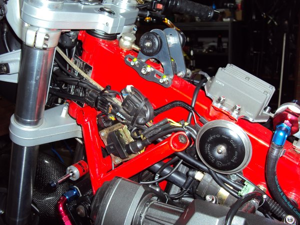

Lucky Phil Posted November 1, 2024 Posted November 1, 2024 (edited) 2 hours ago, DucatiGuzziIndian said: Yeah thats temporary just to get it into the airflow. Winter project to screw around with it to adjust its position so it is at least somewhat straight. Will also try to shorten the turn signal stalks a little, with some type of custom spacer thats a little shorter than the stock spacers currently in place. The reg doesn't need that much airflow as the fins and body act as a heatsink as well as cooling fins. Getting it into the airflow at your location also gets it into the road crud and rain water spray. Here's where mine is fitted and the second image is the location of the Reg on my 1198 Ducati. See the battery, below the battery is the EMU and under that is the REG, right behind the back of the oil cooler outlet and under a side fairing. Both seem to work ok. They aren't old Pommie bike charging systems. Phil Edited November 1, 2024 by Lucky Phil 2

Guzzimax Posted November 1, 2024 Posted November 1, 2024 Much as I love my silver V11 Sport, the Coppa, Rosso Corsa etc, there’s something sublime about a greenie. I don’t think that color will ever be upstaged 2
