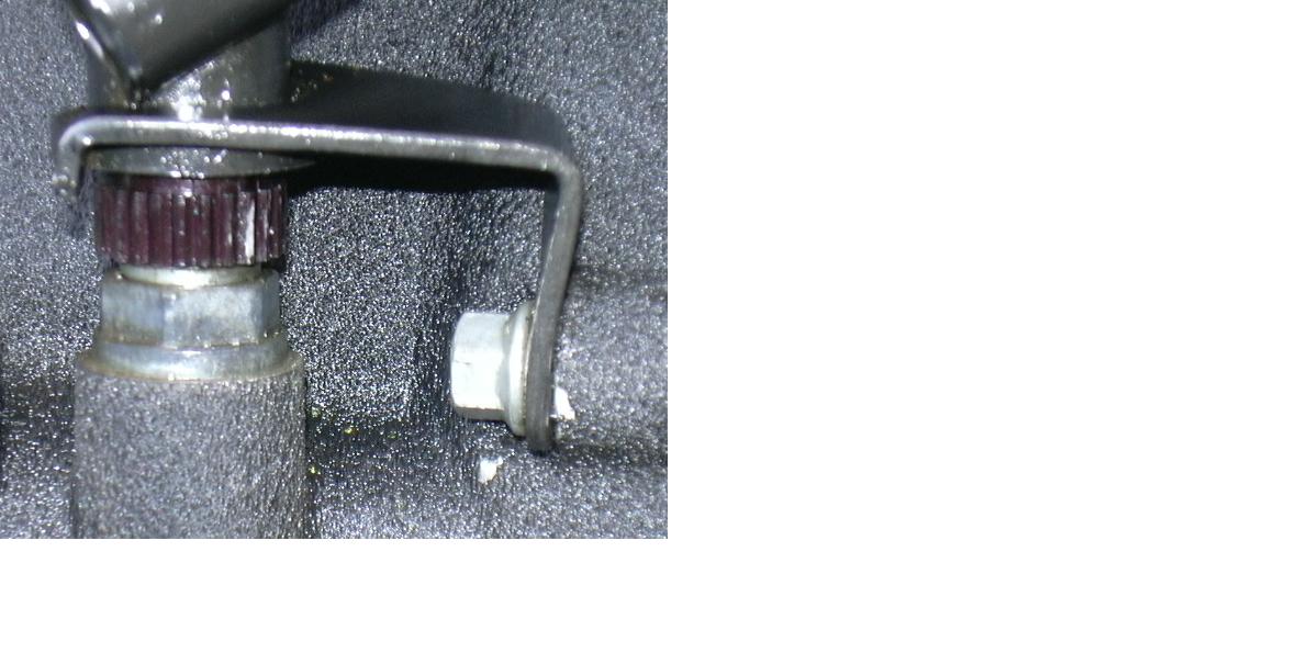

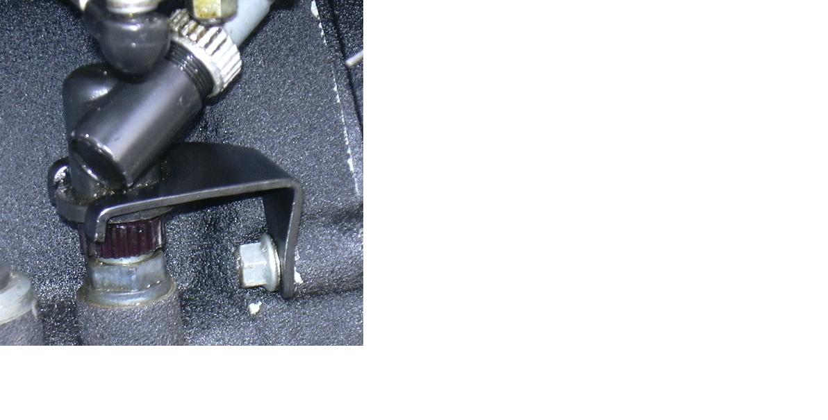

bigbikerrick Posted August 19, 2005 Author Share Posted August 19, 2005 The photo shows the cable where it enters the transmission. The rod at the top is the throttle linkage. Be careful not to straighten the angle too much or it will bind on the rod. Just past that point is where the cable goes up under the tank. The new replacement cable has supposedly corrected this problem - I'm keeping mine as a spare. 58159[/snapback] Ralph, is that photo of the "new and improved cable"? because mine doesnt look like that, yours goes s traight in to the tranny, mine has a plastic housing where ut enters sort of like an angled drive housing, I think it has a little shaft with a gear inside. Doe your bike have the white faced veglia speedometer or the newer black one? Link to comment Share on other sites More sharing options...
bigbikerrick Posted August 19, 2005 Author Share Posted August 19, 2005 Here's a link to the MG service bulletin (it's in Adobe) - http://www.guzzitech.com/V11S-SpeedoCable.html 58166[/snapback] I looked at the service bulletin from MG, they show the spedometer cable ,but refer to it as the tachometer cable! Ahhh, those italians! Link to comment Share on other sites More sharing options...
Ralph Werner Posted August 19, 2005 Share Posted August 19, 2005 Ralph, is that photo of the "new and improved cable"? because mine doesnt look like that, yours goes s traight in to the tranny, mine has a plastic housing where ut enters sort of like an angled Mine is a black faced speedo ('03 Rosso) and the photo is of the original cable housing. I straightened out the angle, and put in a Crown Auto inner cable ($4.00 or so) well lubed with oil and moly. In 7,000 + miles it still seems to be working fine. It sounds like your bike already has the "new improved cable". Lubing it up real good should do the trick. Link to comment Share on other sites More sharing options...

pasotibbs Posted December 9, 2006 Share Posted December 9, 2006 If I understand correctly (not having seen an exploded drive box) this would stop it falling apart ? Its a bit neater than lockwire, if it works ! Link to comment Share on other sites More sharing options...
Guest ratchethack Posted December 9, 2006 Share Posted December 9, 2006 Pasotibbs, it's been my experience and that of a few others that the staked-on disk that's an interference fit in the angle drive housing, has a disturbing tendency to pop out, which will promptly launch the worm gear, along with the entire cable, on the road -- as mentioned by Steve above. Unless you happen to be watching the speedo at the time, you won't know until you find the needle at ZERO whilst underway. I've taken the precaution recommended by others, and epoxied the disk in place with J-B Weld. May I recommend lubing the cable from the top end, which will extend its service life. By the experience of many, they are known to break when they go dry. No need to worry about lube migrating upward and fouling the instrument. The helical winding of the cable housing will ensure that the lube migrates downward into the trans. I use trans lube, which won't pollute the trans, and seems to work just fine. Link to comment Share on other sites More sharing options...
