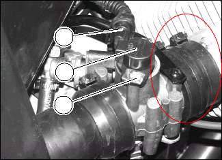

gallo_se Posted August 25, 2005 Posted August 25, 2005 today I noticed the rubber intake boots between the throttle body and the intake manifold has cracks running alongside the clamps alll around the rubber boots. Is this common to these bikes? mine is an 03( really an 02) with a tick over 4000 miles on it. Is there a better replacement available, or a repair? 58545[/snapback] Hi, I don't really understand what part is cracking, my english is not so good, but having a V11 Le Mans with 12500km I am interested, could you post some pictures? thanks

jrt Posted August 25, 2005 Posted August 25, 2005 Hi, I don't really understand what part is cracking, my english is not so good, but having a V11 Le Mans with 12500km I am interested, could you post some pictures? thanks 58553[/snapback] The rubber tube that connects the throttle body and the cylinder (in the red circle):

bigbikerrick Posted August 25, 2005 Author Posted August 25, 2005 Hi, I don't really understand what part is cracking, my english is not so good, but having a V11 Le Mans with 12500km I am interested, could you post some pictures? thanks 58553[/snapback] the part that has cracks is the rubber tube where the gas/air mixture goes into the cylinder, on each side of the motorcycle. Im sorry, but I dont have a digital camera right now.
gallo_se Posted August 25, 2005 Posted August 25, 2005 the part that has cracks is the rubber tube where the gas/air mixture goes into the cylinder, on each side of the motorcycle. Im sorry, but I dont have a digital camera right now. 58574[/snapback] Understood, thanks a lot for the explanation. Cracks in that rubber might be a problem, it was on my California II, after 20 years, and they were in a very bad condition. I would not worry too much, and ,if they have to be replaced, it is not a long work.
