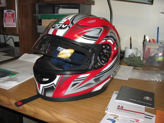

richard100t Posted August 29, 2005 Posted August 29, 2005 Please tell me what kind of agv helmet it is. I just bought a demon top & I wouldnt mind having another.
Guest Britcheflee Posted August 29, 2005 Posted August 29, 2005 richard100t said: Please tell me what kind of agv helmet it is. I just bought a demon top & I wouldnt mind having another. 58916[/snapback] Not qutie sure what the model is - here is a picture - you can e mail me directly at Leentina@comcast.net.....I paid...wait for it $460 - there is a tiny chip on the very back which can easily be painted over and be invisible - I can e mail some pics for you - comes with tear offs and sale price of $295 would include shipping to you. Literally only worn 3 times. Lee
